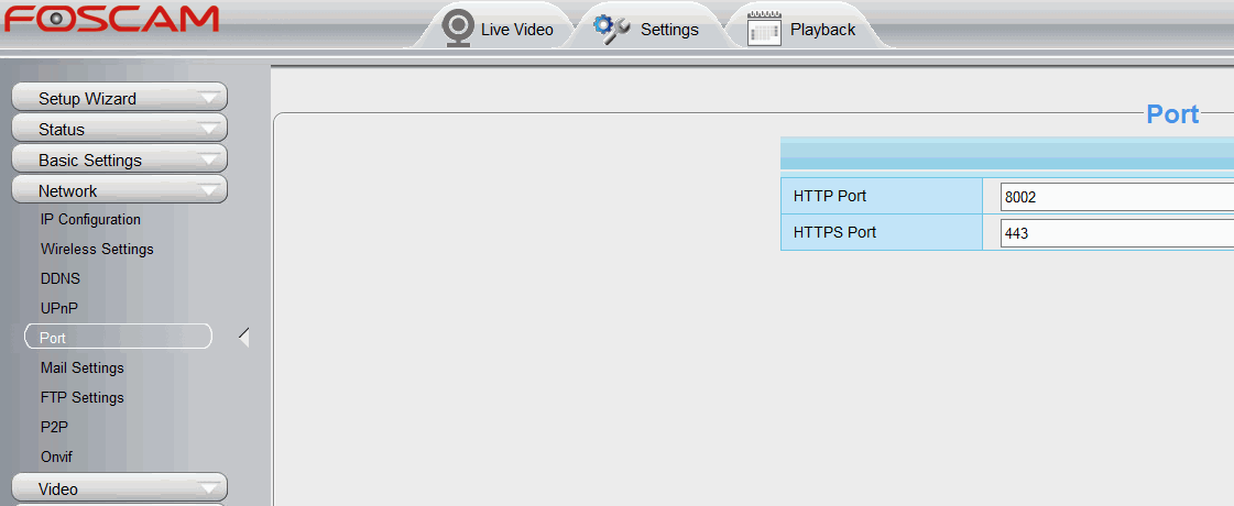

how and where do you get the port from?

Look in your network settings on the camera itself.

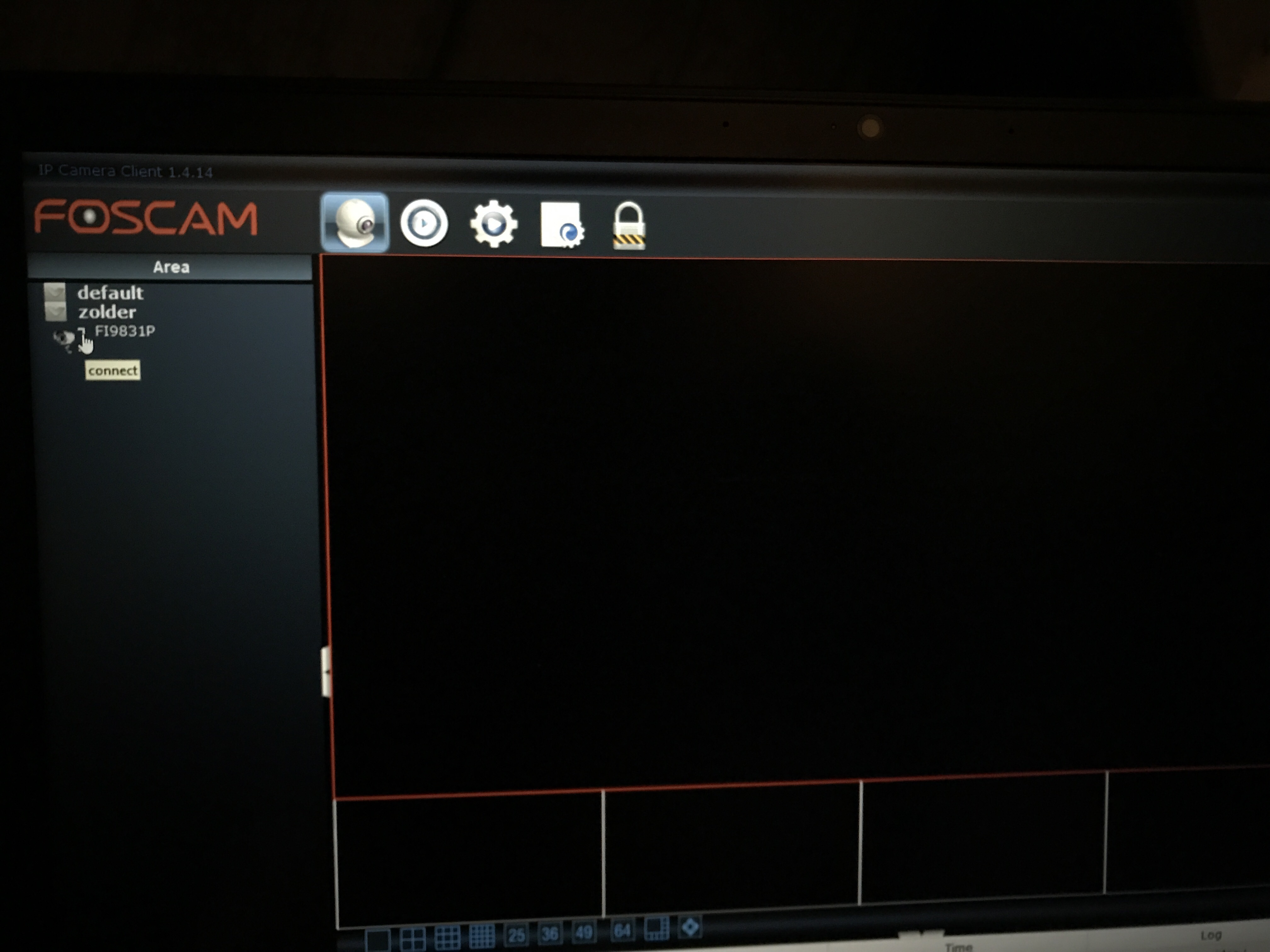

do you have a screenshot for me where to find?
i cant find it
that looks like a Foscam app not the camera configuration web GUI.
to get to the GUI you need to put the camera ip and port into your web browser (XXX.XXX.XXX.XX:PORT) then it will ask for your username and password that you set up on the camera itself.
The port is 88
So now i know that, what do i have to do?
in your browser address bar type in your camera’s IP address and port. For example:
192.168.1.25:88
Then it should load the camera web interface and ask for a username and password.
Once you enter that information then you should see the screen similar to the one I posted above.
