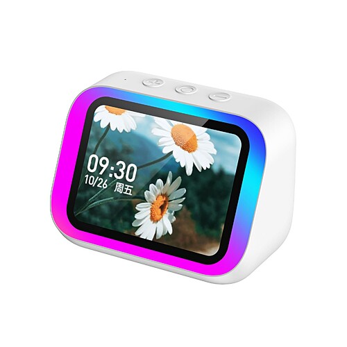

Found a $10 device with speakers and touchscreen that may make a excellent home assistant
So, I found this $10 device on Aliexpress that may make an excellent smart home device. This comes with a built-in touchscreen, mic, and speaker, wifi bluetooth, everything…
I’ve ordered one and plan to get it running with ESPHome. I’m especially interested in seeing how the touchscreen and audio hardware can be used with the new dashboard and voice assistant components.
Has anyone else had a chance to check this out or try flashing custom firmware on it?

It’s Bluetooth. The specs say “Main control chip: AB5682” which is a Bluetooth audio SOC.

You were right. No Wi-Fi, just Bluetooth.
I got too excited thinking it’s an esp chip. What a bummer…

Looks like the same form factor as the Mi Home Smart Clock. Unlikely to be running Android though.
Here is a link to the datasheet for the Bluetooth speaker chip it’s based on.
Doesn’t look to hard to remove that chip and put in an ESP32. ESP32 should be able to control the screen, button, and 3 colors LEDs with no problems but you would be missing the DAC chip.

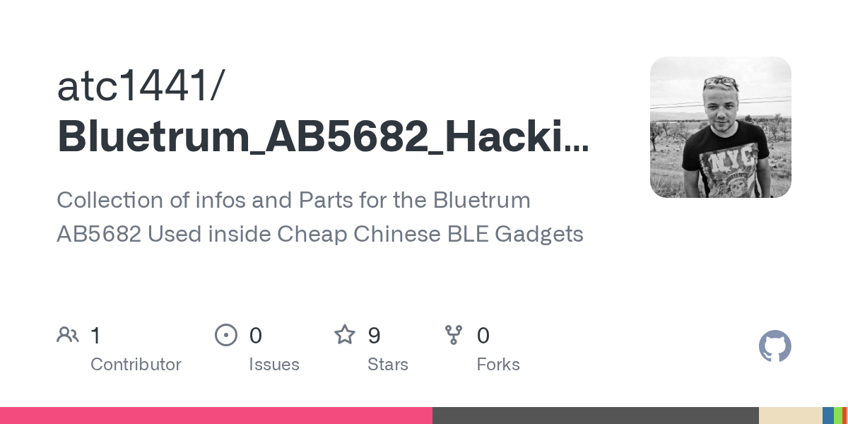

Here is someone who has done some reverse engineering on that chip
