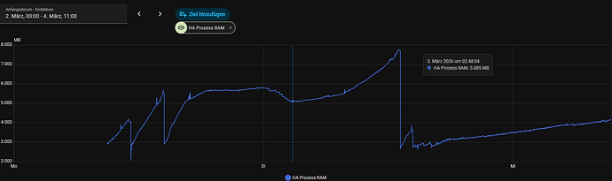

Thanks for the hint, I can see in the monitor, that the memory usage was increasing until the reset, same also with the CPU load.
Main question is now, which add-on or device is using the CPU that much ?

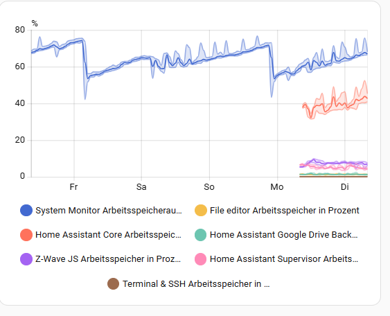

I have now disabled a bunch of add-ons and integrations. Also I enabled the CPU and monitor sensors for some add-ons in the HA Supervisor. Now it is about time to watch :frowning:
Br, Oliver

Seeing this graph, I guess it is only a matter of hours until the next restart
I guess I need to continue disabling add-ons and “devices” until I see some other trend in the graph.
It looks like ONVIF was a culprit in my setup.
After a restart on the weekend, it raced up to almost 8 GB of memory consumption before I started the debugging, etc.
Yesterday I have disabled ONVIF and restarted the instance.
At 16:00 it started with a consumption of a little less than 3 GB and now, about 15 hours later, I am up to a little bit more than 4 GB.
It’s still slowly (sadly steadily) rising - but the increase is a lot less steep.

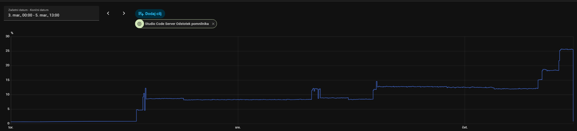

Just for info: VS still IS a memory hog, it’s not resolved. I disabled nightly addon restarts a few days ago and this is the result (drop at the end is because i just manually restarted it):
So, regular addon restarts are back in… it is “kinda” logical, though… if “common thinking” was that CPU was the problem, not memory then this was not addressed, i guess.
