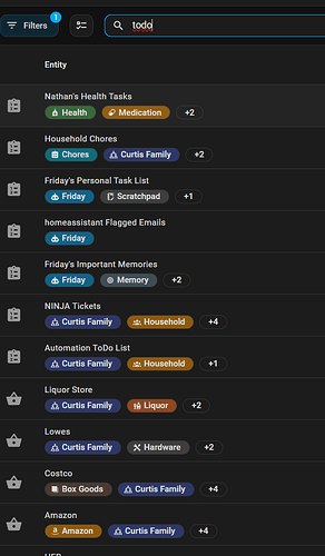

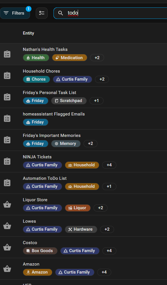

Also, yes there is a reason - I get a notification on my phone when Friday ‘completes’ a task, and I can ediut the lists freom the M365 ToDo app. (I’ll grab the intent code when I get to a point I can - been working on getting the infrerence server back up and running)

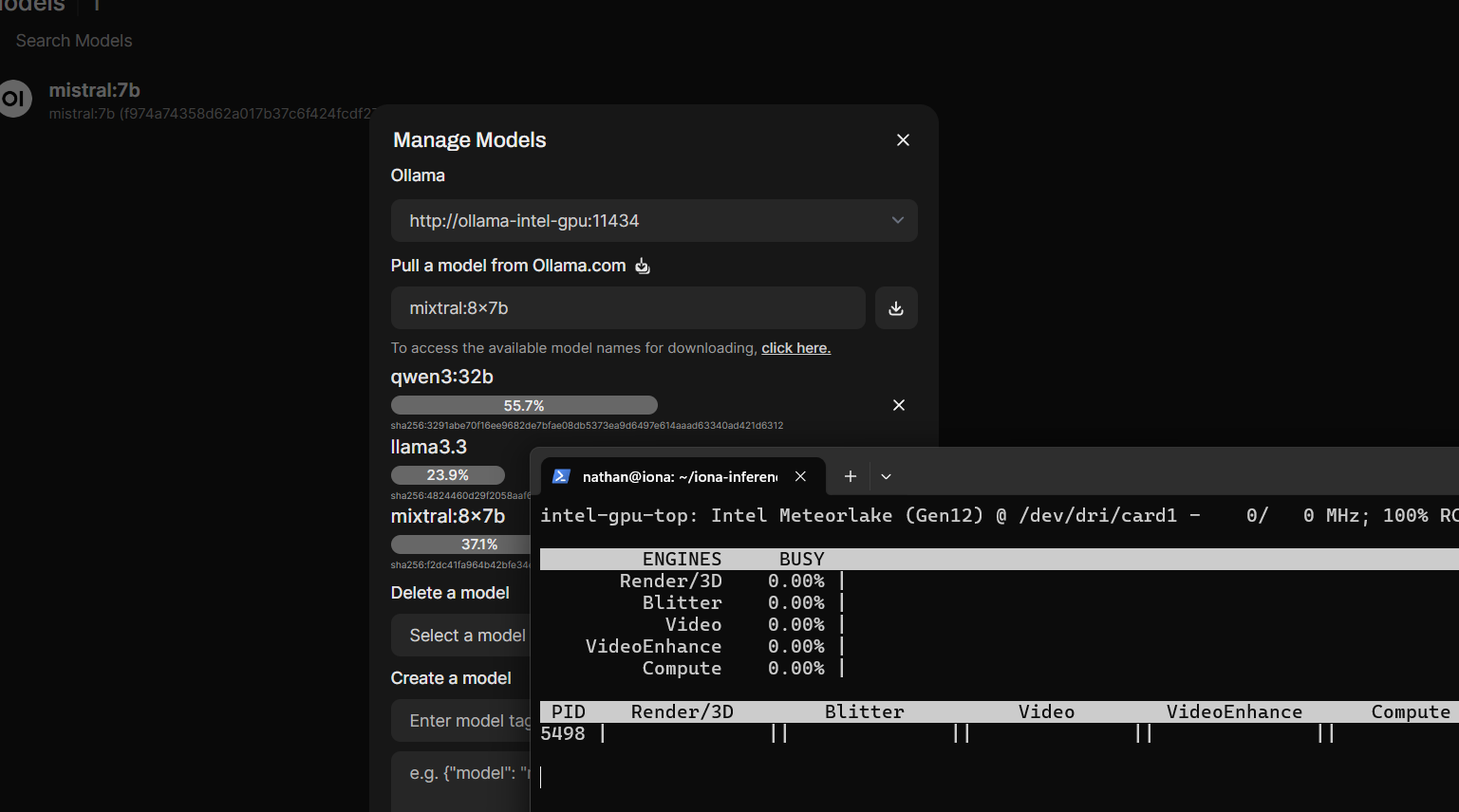

For the monastery host ive built the box unsuccessfully three times (kicks Intel ARC) and had to walk away before the box became a projectile. Should be back on it soon. Hopefully with a fully documented build.

She lost. :smiling_imp: Inference server is up as ‘Iona’ and serving models between 15-30tok/s
Pulling Qwen3 and Mixtral and a few others for some benchmarking then I’ll swing all the scripts back to the new device. After priming the model mistral is smoking…

Thats ninja 3. Requires local inference. Oh look I got iona (the Monastery) server up and running again last weekend… Coincidence?

Updated CRUD Controllers 1.2
Updated current CRUD controllers - added help to todo and added target by label to both.
FIRST, Go nuts with labels on your todo and calendar entites…
…then
read from all shopping lists,
read all my work calendars,
tell me the family chores…
Whats on our shopping listS (yes aggregated in one call)
