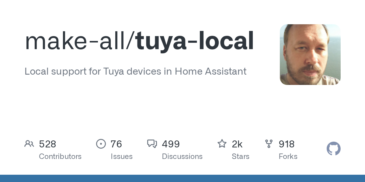

Will plug TuyaLocal instead of LocalTuya. Works way better. Didn’t need to map any DPs and devices work almost as if they were native to HA.

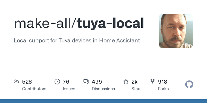

I’ve fully switched to this integration and have been super pleased for over a year (maybe coming up on two now I forget)
It’s fully local
