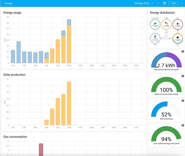

I too have a Frient energy monitor (well 3 actually, mine are on 3 different solar arrays) I’m interested to know how you got the display you posted above as I too am usung Zigbee2MQTT but my display looks nothing like yours
Maybe repair or update to the latest zigbee2mqtt. Mine looks like the first posting.

To show the other options you definitely need to run the latest version of Z2M, then it should show up automatically.

I was sure I was running the latest Z2M but after checking again this morning I realise I wasn’t, THANKYOU.
