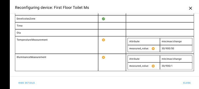

I’ve tried deleting and re-adding.
I’ve factory reset the device, then re-added it. It’s stops at interview complete, Configuring.
I left it at that stage for some time, came out of the device search section and reviewed the device. It now says the device has no entities.
There is a mains powered zigbee sonoff light controller above it and this is all very close to the co-ordinator. Any ideas?

[0x93DE:1:0x0008]: async_initialize: all attempts have failed: [DeliveryError(‘Request failed after 5 attempts: <Status.MAC_NO_ACK: 233>’), DeliveryError(‘Request failed after 5 attempts: <Status.MAC_NO_ACK: 233>’), DeliveryError(‘Request failed after 5 attempts: <Status.MAC_NO_ACK: 233>’), DeliveryError(‘Request failed after 5 attempts: <Status.MAC_NO_ACK: 233>’)]
[0x93DE:1:0x0006]: async_initialize: all attempts have failed: [DeliveryError(‘Request failed after 5 attempts: <Status.MAC_NO_ACK: 233>’), DeliveryError(‘Request failed after 5 attempts: <Status.MAC_NO_ACK: 233>’), DeliveryError(‘Request failed after 5 attempts: <Status.MAC_NO_ACK: 233>’), DeliveryError(‘Request failed after 5 attempts: <Status.MAC_NO_ACK: 233>’)]

I have the same problem. I added the sensor but it has no entity. Another thing to do ?
had the same problem. after deleting the frient sensor device, every re-pairing would not show any entities anymore. tried everything and what helped was: changing the name of the dongle and the frient sensor after pairing so that it changes the name of the entities too. then they would show up
