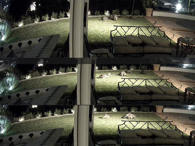

Before I start, I wanted to say that I sincerely appreciate your help.
The following is a set of pictures of what I have been fighting to deter (by activating the sprinkler in that zone) from last night. They were at it for 45 minutes.
I hear your suggestion to fine tune the detection process through the debug view, but raccoons show up at around 11:30pm – 2:00am, and not every night. It’s very hard to stay up every night to catch them on debug view.
To start, I will remove the person and raccoon objects and keep either dog and cat objects. I also removed all filters.
