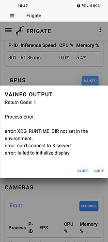

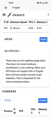

So I got this after adding the ffmpeg line under the camera settings in frigate.yaml. I guess it’s normal? How to know everything is ok?
yes, rpi does not support gpu stats
So I am good? No need for other set up? And no removing Protection mode or anything?
