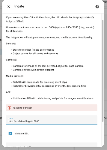

I am getting Failed to connect when trying to Submit Frigate integration. I did not input a username/pass as it says it is OPTIONAL.
I can not reach the server address on port 5000 with http. Does this mean Frigate is running on a different port or different IP?
This is HaOS standard install with Frigate installed as add-on and works well with one camera showing.

I just ran in to this issue also. on this web page. Look down the pages. There is a section that talks about hass-addon. I am running the Full Access version. I had to change my url to include -fa. What version are you running? You should find it in that list.
Did you end up resolving this error? I am getting the same.
Have installed the full frigate home assistant addon. I can see it running with I click the ‘open webUI’ button.
Can see that frigate has logged into the MQTT broker.
I also commented out the TLS entry in the config as well:
# tls:
#  enabled: false
For anyone following or coming across this post. I had to add “-fa” (full access apparently) after the url address. So it reads http://ccab4aaf-frigate-fa:5000.
