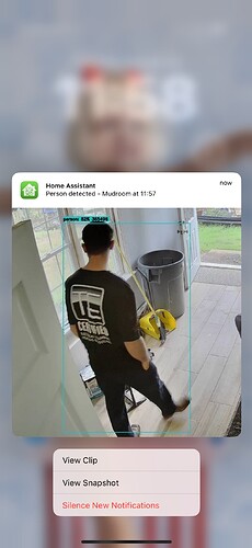

I was able to capture the example live.
From what I see in experience even if updated image is checked it fires an initial warning then the updated works. In my example shown this is the second, updated image notification. I saw the first one and thought I had a screenshot of it but didn’t save. It showed a 404 error screen.
UPDATE: Caught the error as shown.
