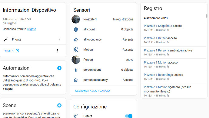

Frigate is working well in the docker and it is saving clips and in snapshot in the media folder of my NAS but I’m not sure there is a proper comunication with HA.
In HA I can see the camera but the Person recorded is an older image and not updated.

but I have the following message:
Impossible to load the attachment. Response startus code was unacceptable:400
