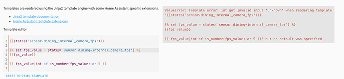

Error rendering variables: ValueError: Template error: int got invalid input 'unknown' when rendering template '{{ fps_value|int if is_number(fps_value) or 5 }}' but no default was specified
This appears to come from these lines in the blueprint:
fps_value: '{{ states(''sensor.'' + camera + ''_camera_fps'') }}'
fps: '{{ fps_value|int if is_number(fps_value) or 5 }}'
At this point, I tried checking for the sensor name using the DevTools, and discovered that my camera name "Dining-Internal’ isn’t there, because the hyphen has been changed to an underscore. The sensor name is in fact sensor.dining_internal_camera_fps.
So if you see the DevTools screenshot below, that code produces the same error as seen in the log:
But if I change the camera name to replace the hyphen with underscore…
So it seems that underscores in the camera name cannot be tolerated by this blueprint. Some people might say, don’t use hyphens in the camera names, use underscores, but I have hyphens in the camera names because DNS doesn’t support underscores, only hyphens!
Since all my cameras bar 1 have hyphens in the name, I was going to have to change the automation to work on PondCam! However, creating detection on this cam at this time of night was going to be awkward… But to entice the fish, I went out and threw some food near the underwater camera to see if they would come up…
And voila… After waiting about 20 minutes, Frigate finally detected a fish (person) and I received a notification along with the URL / thumbnail / video link etc as expected!!!
So since I don’t want to rename all my cameras, I’ve looked at the template code and in particular the variables section around line 159 that is setting the camera_fps variable and added extra code in there to replace hyphens in the camera name with underscores as follows
fps_value: '{{ states(''sensor.'' + camera | replace(''-'',''_'') + ''_camera_fps'') }}'
