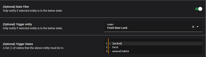

I tried to configure it to send a notification only when the alarm is activated, I am not sure if I did something wrong, but I always get notifications whatever is the state of the alarm.
I enabled the state filter, set the trigger entity to Alarm and set the trigger states to:
The version of the blueprint I originally posted works for me using a door lock and the locked state listed.

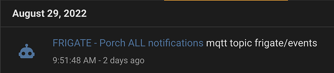

Yesterday and the day before I was getting notifications perfectly, today frigate seems to working fine when it comes to creating events, but no notifications are being sent anymore.
Not even the automation are triggering, even though frigate is creating events:
This somehow looks like an MQTT problem to me maybe, I’m running frigate on an RPI4 using HA OS.

Your UI config looks good.
I just woke up and I have 3 notifications on my phone the past 2 hours. I see many more events in frigate and reviewing several of them it appears to be working correctly in that I see only notifications when my front door is locked.
I am curious if you might be experiencing a known UI bug when multliple entities have the same friendly name. to check this, view the automation in yaml mode and check the correct entity id is actually set for your Alarm.
I am going to do one more test and rearrange my states so that locked is not first, just to test that also.
Edit 1 day later: I am still seeing successful differentiation between locked and unlocked triggering notifications. I’m not sure why your case would be causing issues.
