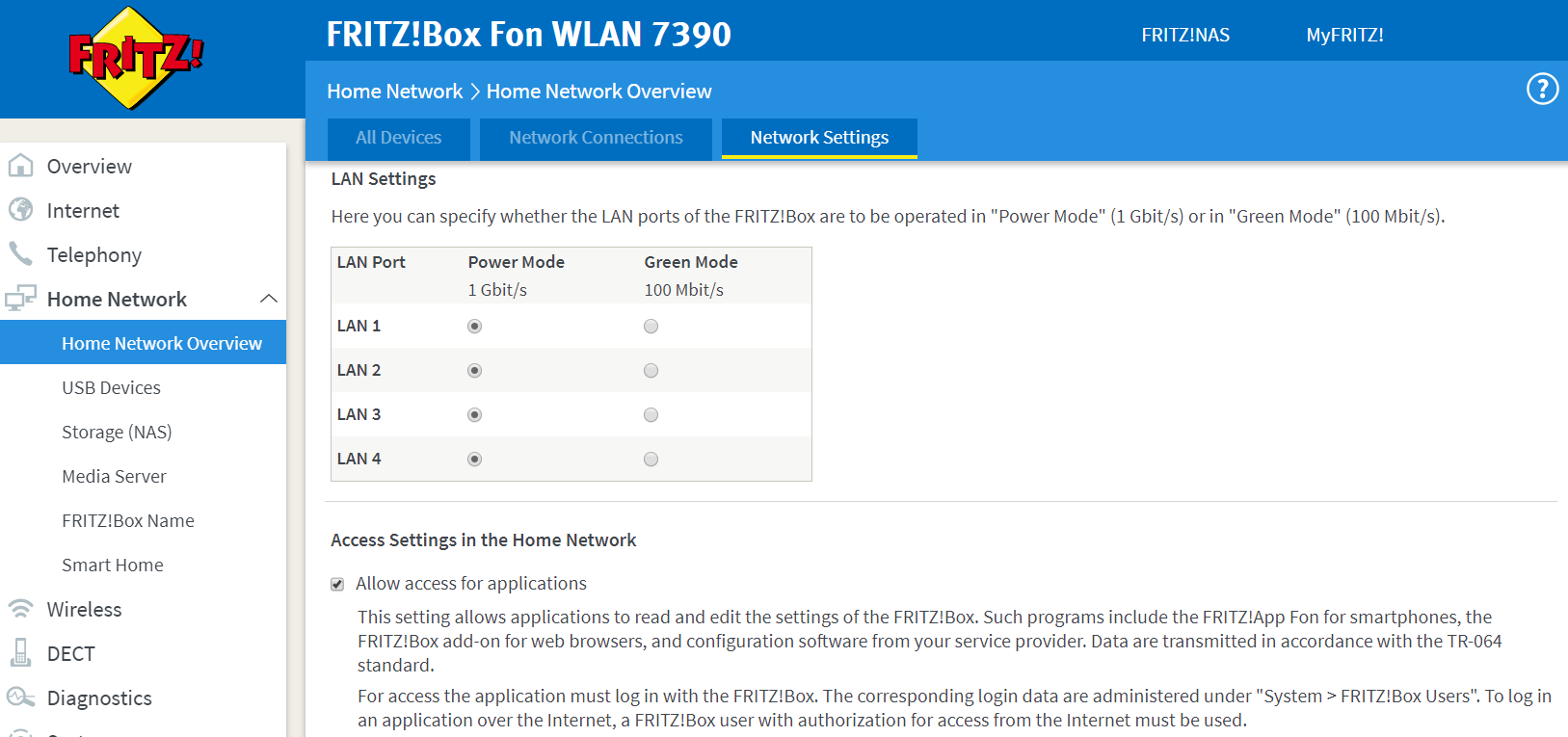

I was able to get it working in my setup now. I had disabled a setting in the Fritz!Box which must be enabled for the phonebook lookup feature to work.
The setting is found in “Home Network” -> “Network Settings” and it’s called “Allow access for applications”
