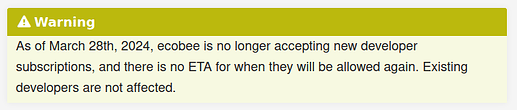

To do that, you need an API key. Do you already have one?
Pretty positive I’ve snagged API key when started thinking about this project few months ago, will need to doublecheck when back at my desktop. Thank you
P.S.: sounds like they’re going crappy Chamberlain road, time to start looking for a new thermostat…
Good thinking. That API key is valuable now.
However it’s my understanding that using the Homekit protocol has certain advantages because it adheres to an established standard, is completely local, and does most (but not all) of what can be achieved via ecobee’s API.
In contrast, Chamberlain blocked access to the unofficial API and dropped support for Homekit.
