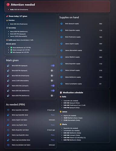

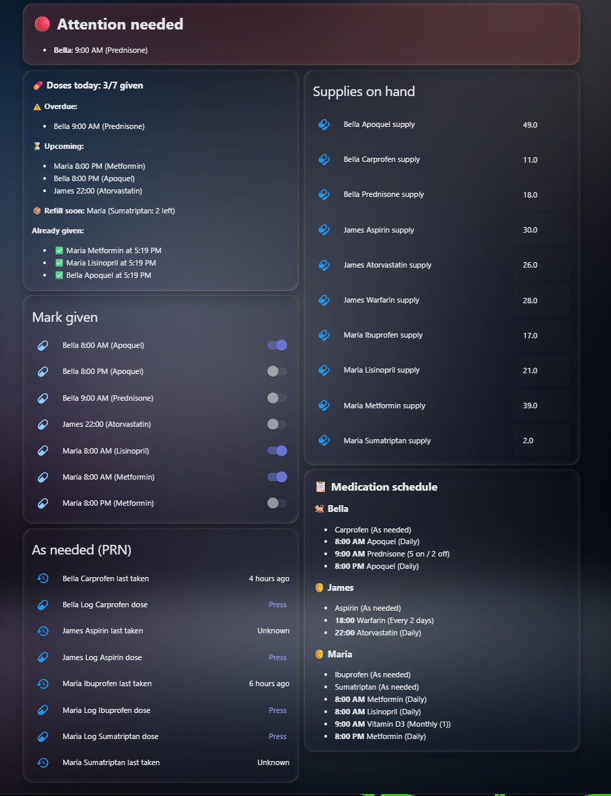

The whole thing is a zero-edit, auto-discovering dashboard.
A few of the turns it took, thanks to people in this community:
  • @IOT7712 pushed for a glanceable, fail-safe red/green "needs attention" indicator for care settings. That idea became a core part of how the whole thing warns you.
  • @Tadies inspired the supply and refill tracking, after building a pill counter on a dashboard with helpers.
  • Others asked for more schedule types, for the ability to record the actual time a dose was taken (not just when you tapped the button), and most recently for a way to see how many as-needed doses had been taken today. All of those shipped.

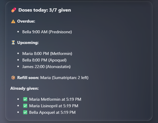

The day at a glance: given, still due, overdue, and the times doses were actually taken.

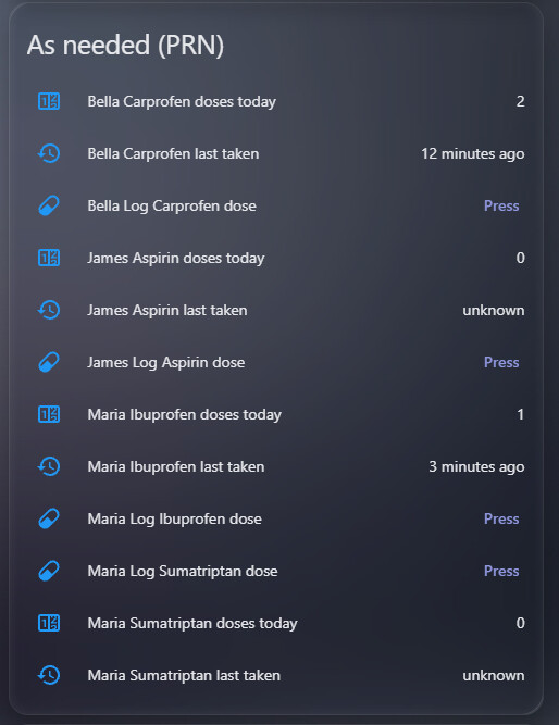

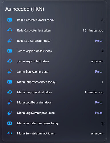

  • As-needed meds get a Log dose button, a "last taken" timestamp, and a "doses today" counter, and they draw down supply, so a med taken several times a day stays tracked.
As-needed meds: log a dose, see when it was last taken and how many today.
