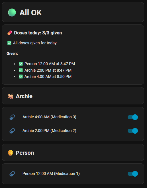

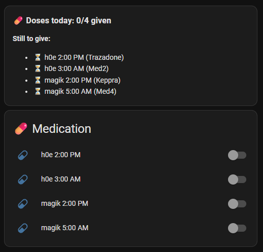

here is a dashboard I am using atm.. :call_me_hand:

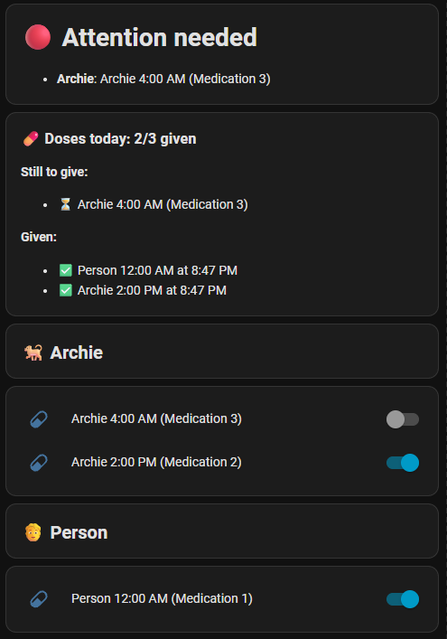

A lil mockup..
Thanks again for these. This actually started as a way to keep on top of my own dogs' daily meds, a couple of them are on a multi-dose seizure schedule where a missed or doubled dose genuinely matters, so your framing around a reliable, glanceable indicator for care settings hit close to home.
It shipped in v0.6.0. Each patient now has a "needs attention" sensor (a standard problem binary sensor): green when all is well, red the moment a dose goes overdue. There's a simple red/green status panel that sits above the detail grid (your "forest, then trees"), and an optional flashing version via card-mod. Since it's just a normal entity, you can as easily drive a lamp, siren, pager, or notification off it for a physical alert that's visible across the room.
On the reliability you stressed: the status re-evaluates on a timer, not just on changes, so a dose crossing into "overdue" trips it red with nobody touching anything. And it fails safe toward "problem" rather than a false "all clear," because a false green is the dangerous direction here. The reminder timing itself rides on Home Assistant's automation engine rather than custom code, for the same reason.
I also credited you in the README for the suggestions. The framing around a fail-safe indicator for care settings genuinely shaped the feature.

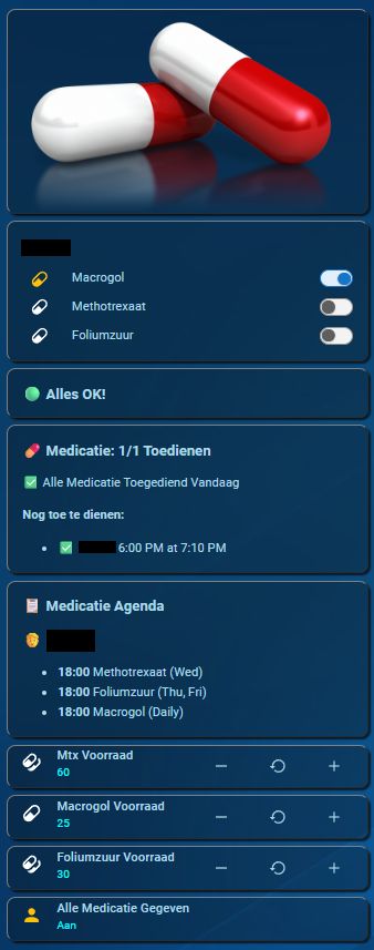

as i promissed......
it works like a charm....
i even builded the pills counter to it..
it counts how many pills there will be left after (meds-Given)
with help of counter helpers and a little yaml ...
ty....
This made my week. Seeing the day-of-week scheduling actually running, Methotrexaat on Wed, Foliumzuur Thu/Fri, Macrogol daily, is exactly what I hoped people would do with it. It also gives me some ideas to extend!
And the pill counter is brilliant. Counting how many doses are left after each one is marked given is genuinely useful, that is the kind of thing that stops you running out mid-week. Any chance you'd share the counter helper + template YAML? I'd love to point others to it, and honestly it makes a strong case for baking supply tracking and low-stock refill reminders right into the integration.
Bedankt for sharing this, and for the feedback that shaped the scheduling. Looks great.
