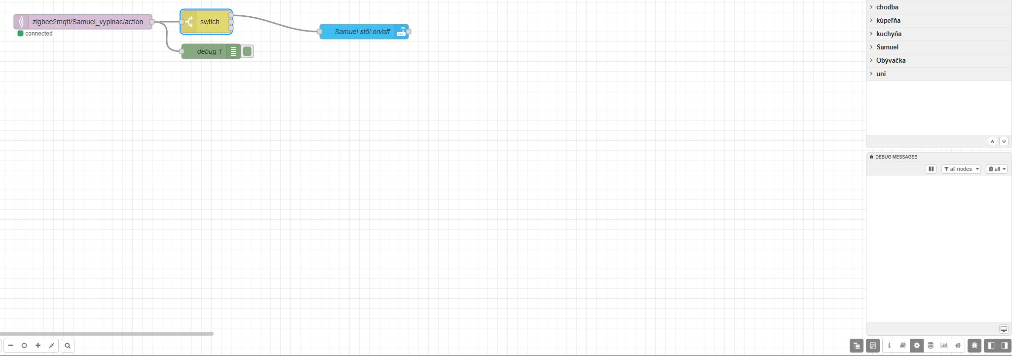

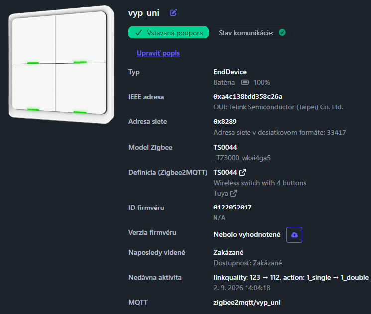

I have a problem with the integration of the 4 switch. In zigbee2mqtt everything works and shows the status after pressing, but in node-RED it does nothing

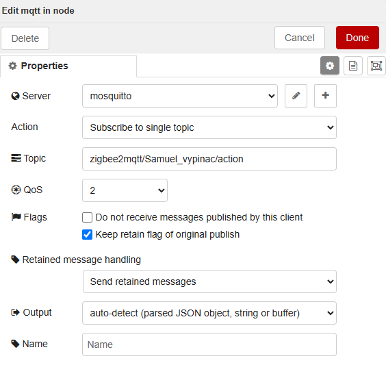

Your mqtt node(zibee2mqtt) says connecting under it, it should say connected. This tells me there is either a problem with the mqtt app, like it’s not running or your credentials are wrong.
If mqtt is running, click on the mqtt node and look to see if you have the right server selected and that the user name and password are correct. To see the server settings click the pencil icon.
dont know why
my mosquito server was wrong setup

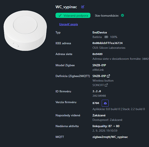

another problem with another switch that doesn’t respond
and this throws a message in debug
2. 9. 2026 19:10:12node: f25ad0403a56b603msg : string[27]
“Failed to parse JSON string”

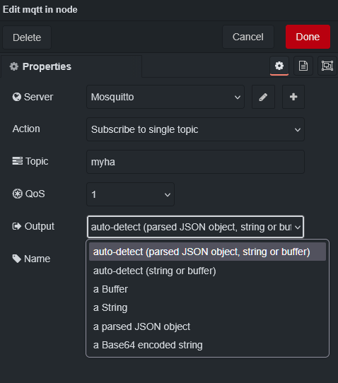

Try setting it to a String.
nothing changed

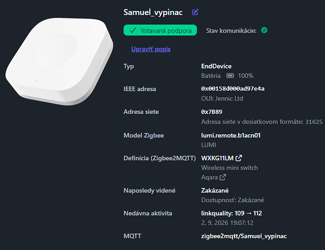

when I rename from
zigbee2mqtt/Samuel_vypinac to
zigbee2mqtt/Samuel__vypinac it works ![]()
is it possible to somehow clean old names or something in system?
With the addon/app an easy way to clear everything is to delete it and turn on the switch to delete all data. Otherwise you can publish an empty string "" to the topic with retain set to true.
