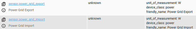

Unfortunately, Home Assistant gives me these errors:
statistics_not_defined
- sensor.total_power_grid_import_energy
Entity unavailable
The state of these configured entities are currently not available:
- sensor.total_power_grid_import_energy (unknown)
Unexpected device class
The following entities do not have the expected device class:
- sensor.total_power_grid_export_energy
I have included some sensor state screenshots below. Any advice would be appreciated. Thank you in advance.
