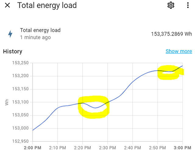

So I think that I have energy dashboard setup correctly as I see the data in HA is showing the same info as the fronius app.
I do not have a battery so my simple maths to calculate energy consumed (used) is
solar energy produced - energy exported to grid + energy imported from grid
I have all three of the data above from the integration so I have a template sensor to calculate energy consumed.
Is this correct? I am asking as I have a slight decrease in energy consumed and this should not be possible.
Maybe a small glitch in the data? Or if the sampling rate is different between the source data sensors?
So after a bit of investigating I see that energy exported and energy imported are updated every minute but solar production is updated every 5 minutes in HA.
This explains the issue I am seeing as I am not getting updated solar production data but energy exported includes new solar production.
I’m thinking the easiest fix is to use a time triggered template sensor and update every 5 mins.
