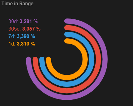

@Bart_Huitsing Love the idea of the radial chart and im playing about with Measureit as suggested though it appears to measure in seconds … what scale is this graoh using as right now the % are not what they should be
Based on the initial dashboard by @CaptainSweatpants I created a single Lovelace card which basically holds all the current information in one mini graph. I decided to share it as it might be of value to others.

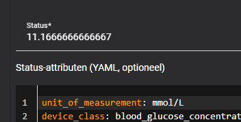

I don’t know if this is the place to ask, but I have been using a nice view on my glucose values for a while now. Ever since 2025.6.x it is not working very good anymore (also not on 2025.7.00.bx).
It used to show the current value, but now it either shows the value with a lot of decimals after the comma, or it shows n/a.
type: custom:button-card
entity: sensor.dexcom_user_glucose_value
show_entity_picture: false
show_last_changed: false
show_icon: false
show_name: false
     return `<span>${(states['sensor.dexcom_user_glucose_value'].state)} mmol/L</span>`
styles:
  card:
    - border-radius: 2%
    - padding: 2.5%
    - color: ivory
    - font-size: 12px
    - border-width: >
        [[[ if (states['sensor.dexcom_glucose_status'].state === 'Binnen
        bereik') return '0px';
            else return '2px';
    - border-color: >
        [[[ if (states['sensor.dexcom_glucose_status'].state === 'Erg laag')
        return 'red';
            if (states['sensor.dexcom_glucose_status'].state === 'Laag') return 'orange';
            if (states['sensor.dexcom_glucose_status'].state === 'Hoog') return 'orange';
            if (states['sensor.dexcom_glucose_status'].state === 'Erg hoog') return 'red';
            else return 'none';
  grid:
    - grid-template-areas: "\"img img\" \"trend trend\" \"update update\" \"range range\""
    - grid-template-columns: 1fr 1fr
    - grid-template-rows: 1fr min-content min-content min-content
  img_cell:
    - justify-content: middle
    - align-items: start
    - margin: none
    - padding-bottom: 5px
  icon:
    - width: 15%
    - margin-top: 0%
    - color: red
    - padding-bottom: 0px
  custom_fields:
    state:
      - align-self: start
      - justify-self: end
      - font-size: 17px
    update:
      - font-family: helvetica neue, helvetica, Arial
      - font-weight: 500
      - font-size: 15px
      - color: grey
      - align-self: middle
      - margin-top: 0px
    trend:
      - color: rgba(255, 255, 255, 0.7)
      - font-size: 15px
      - font-weight: 300
      - text-align: center
    range:
      - font-size: 15px
      - font-weight: 500
      - line-height: 30px
      - color: white
      - background-color: |
            if ((states['sensor.dexcom_glucose_status'].state === 'Erg laag'))
              return "red";
            if ((states['sensor.dexcom_glucose_status'].state === 'Laag'))
              return "orange";
            if ((states['sensor.dexcom_glucose_status'].state === 'Hoog'))
              return "orange";
            if ((states['sensor.dexcom_glucose_status'].state === 'Erg hoog'))
              return "red";
            else
              return "none";
    img:
      - font-weight: bold
      - font-size: 15px
      - color: >
          bereik') return 'grey';
          return "orange";
          return "orange";
              else return 'red';
      - padding-bottom: 65px
custom_fields:
  trend: |
    [[[ if (states['input_number.dexcom_change'].state > 0)
          return `${(states['sensor.dexcom_user_glucose_trend'].state)} (+${Math.round(states['input_number.dexcom_change'].state)})`;
        return `${(states['sensor.dexcom_user_glucose_trend'].state)} (${Math.round(states['input_number.dexcom_change'].state)})`;
  update: |
    [[[ return `${(states['sensor.dexcom_last_update'].state)}`; ]]]
  range: |
      if ((states['sensor.dexcom_glucose_status'].state === 'Erg Laag'))
        return "Erg Laag";
        return "Laag";
        return "Hoog";
      if ((states['sensor.dexcom_glucose_status'].state === 'Erg High'))
        return "Erg hoog";
      if ((states['sensor.dexcom_glucose_status'].state === 'Binnen bereik'))
        return "Binnen bereik";
      else
        return "N/A";
  img: |
        if (states['sensor.dexcom_user_glucose_trend'].state == "steady")
          return `<img src=/local/icons/dexcom-steady.png
          style="width: 170px; height: 170px; color: #00def;">
          </ha-icon><span style="font-size:30px; margin-top:-111px; display:block;">${(states['sensor.dexcom_user_glucose_value'].state)}</span><span style="font-size:13px; margin-top:0px; display:block;">mmol/L</span>`;
        if (states['sensor.dexcom_user_glucose_trend'].state == "rising slightly")
          return `<img src=/local/icons/dexcom-risingslightly.png
        if (states['sensor.dexcom_user_glucose_trend'].state == "falling slightly")
          return `<img src=/local/icons/dexcom-fallingslightly.png
        if (states['sensor.dexcom_user_glucose_trend'].state == "falling")
          return `<img src=/local/icons/dexcom-falling.png
        if (states['sensor.dexcom_user_glucose_trend'].state == "rising")
          return `<img src=/local/icons/dexcom-rising.png
        if (states['sensor.dexcom_user_glucose_trend'].state == "falling quickly")
          return `<img src=/local/icons/dexcom-fallingquickly1.png
        if (states['sensor.dexcom_user_glucose_trend'].state == "rising quickly")
          return `<img src=/local/icons/dexcom-risingquickly1.png
          </ha-icon><span style="font-size:30px; margin-top:-111px; display:block;">N/A</span><span style="font-size:13px; margin-top:0px; display:block;">mmol/L</span>`;
tap_action:
  action: none
I have tried to alter some code myself, but can’t seem to figure it out.
The sensor sensor.dexcom_user_glucose_value has the correct value. I can also see the color change based on the value, but the value itself doesn’t show.

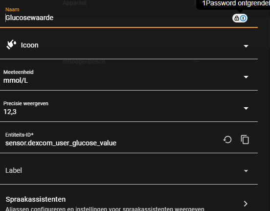

The decimals is set to 1, see:
But using debug tools it is with a lot of decimals:
Just a guess. Change:
to:
<span>${parseFloat(states['sensor.dexcom_user_glucose_value'].state).toFixed(2)} mmol/L</span>
This would change 11.166666666666667 to 11.17

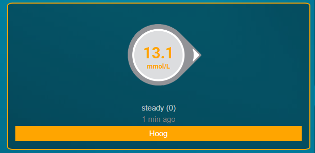

It looks like below. The arrow on the right changes up down or just to the right based on the trend.
This is with your suggestion included. The strange thing is when I change mmol to something completely else, it doesn’t show. I’ll try and put into a clear dashboard to see if that helps.
other dashboard didn’t help, so it is in the card. I changed the mmol, but that’s part of the IMG: block. Doesn’t hold the actual value.
Cool! With your code I’ve edit the last IMG block and added the rounding to all parts. Now it is nicely rounded. Thanks a lot!
