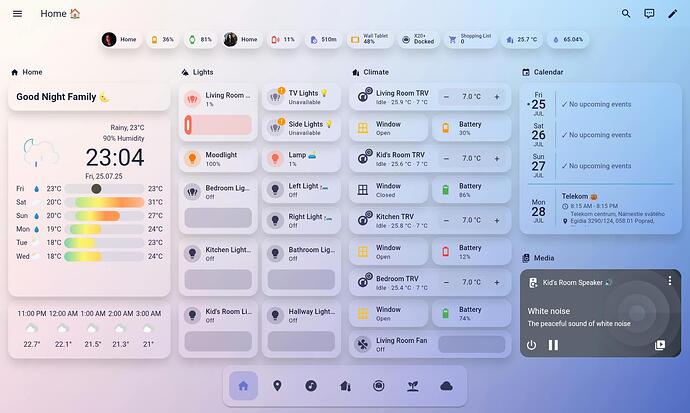

:framed_picture: Screenshots
:sun: Light Mode:

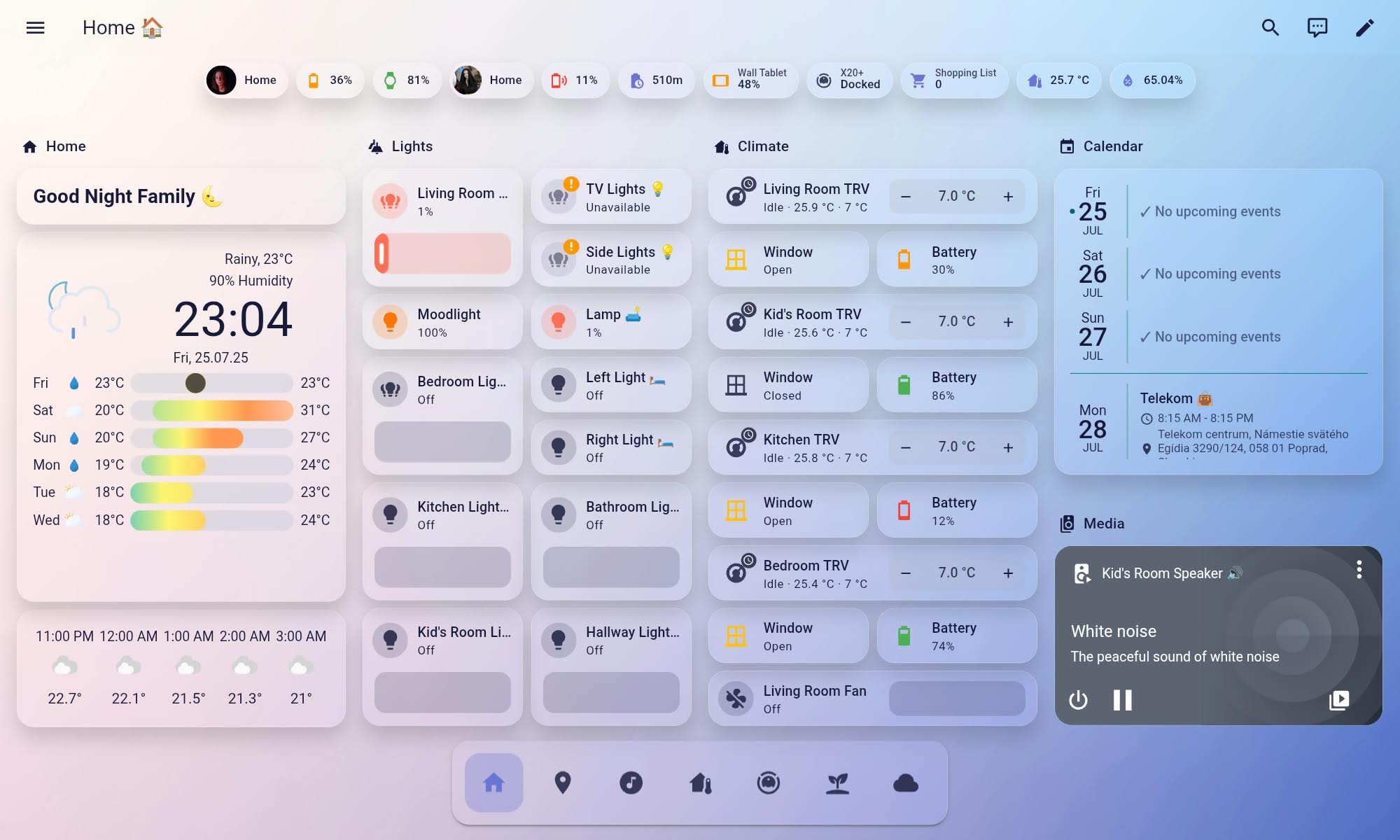

:new_moon: Dark Mode:

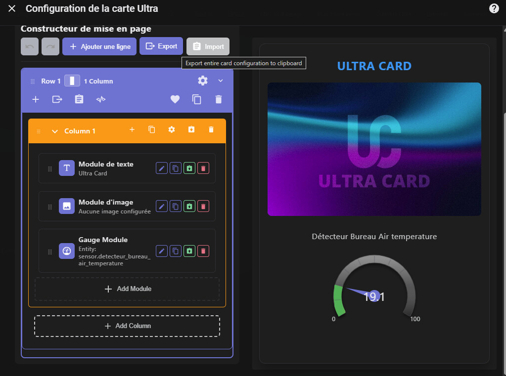

Hello, i used your theme since some weeks now, congratulations about your dev !

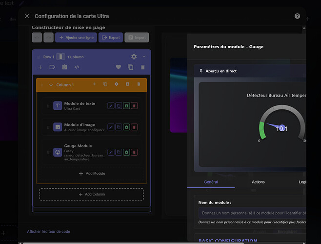

I have an issue with Ultra Card.
It’s your theme because if i change the theme with another, everything works.
What is the issue ?
if i edit a card :
exemple a gauge :
and i want to close the window, the window move to the right without the possibility to close this window :wink:

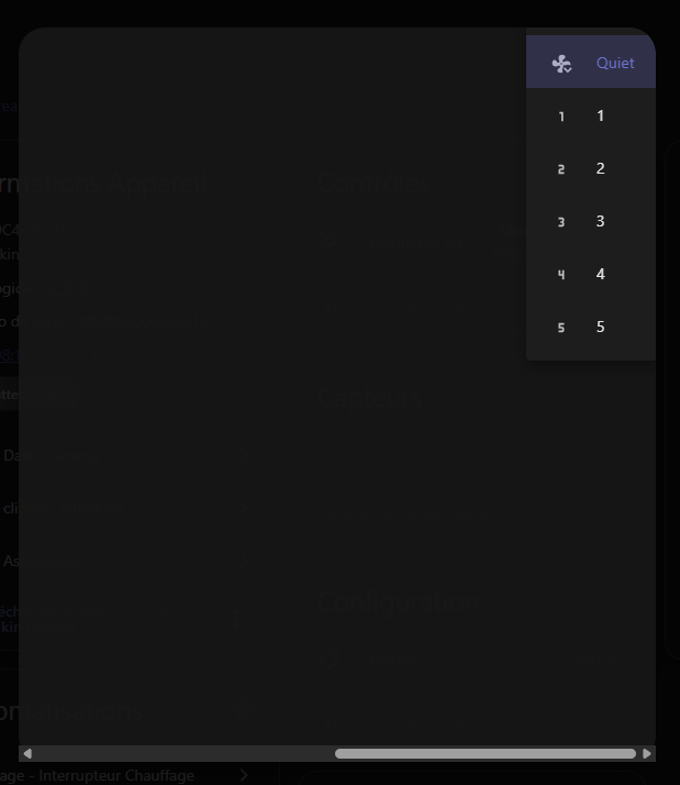

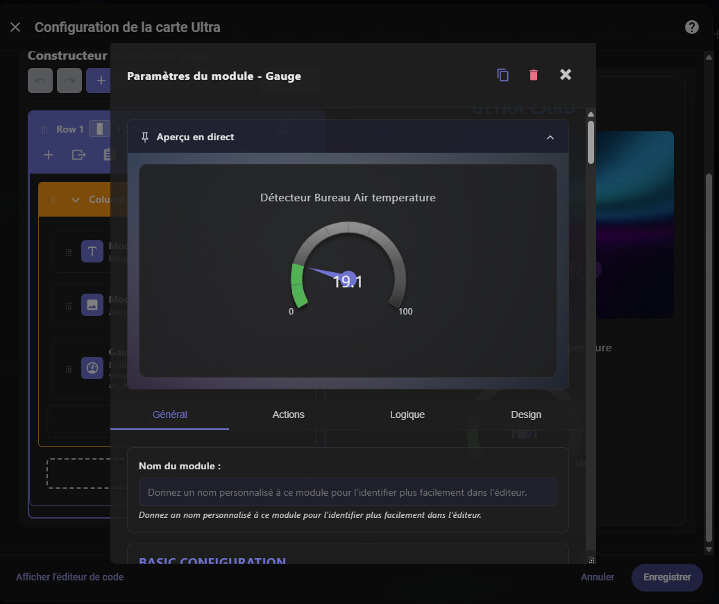

The same problem with finaly “select” usage.

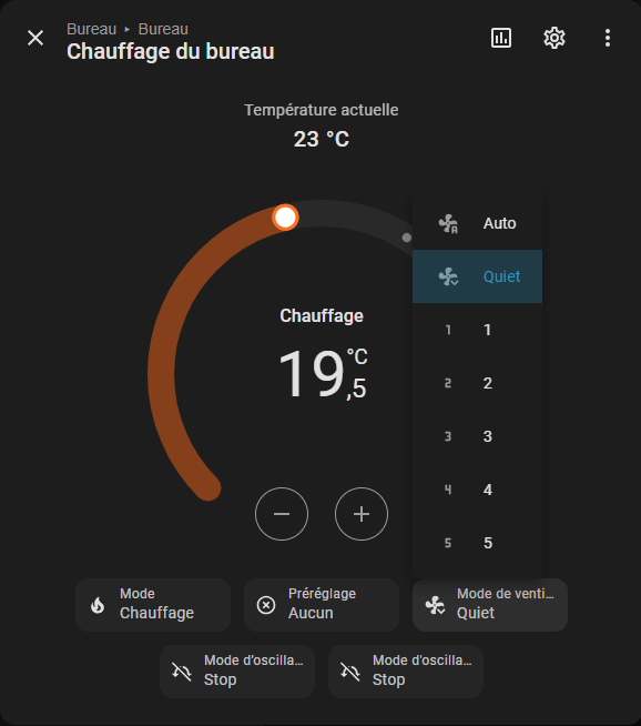

Another example :
if i select “Mode de ventilation” , the problem is present also

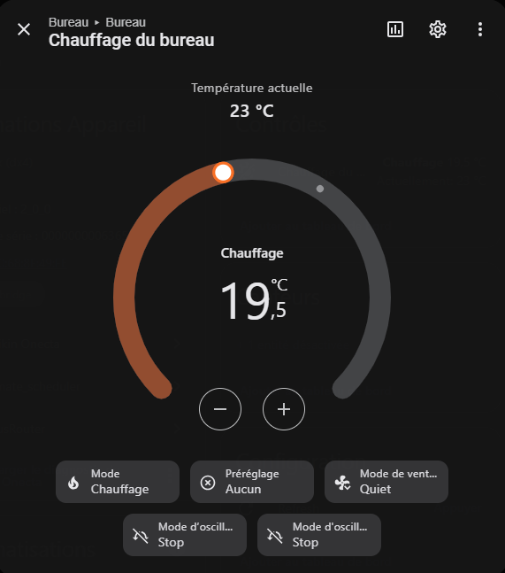

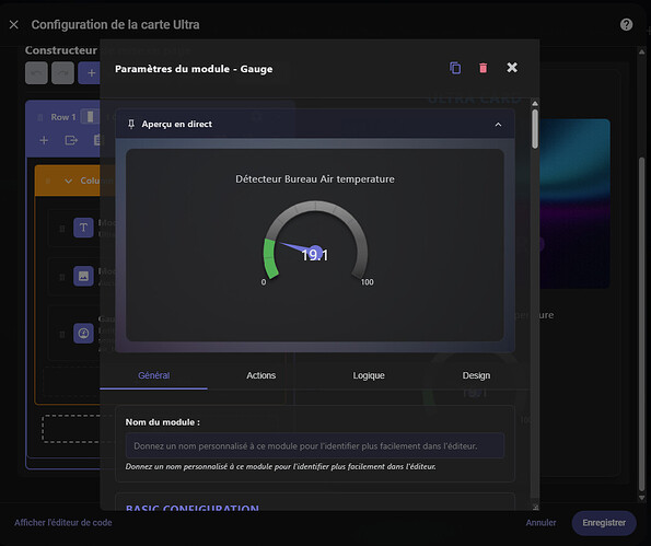

with Basic theme like Mushroom, the issue is not present :

@wessamlauf , i think i found the problem :
To avoid this issue, we must change this line :
DIALOGS
ha-dialog-surface-backdrop-filter: ‘blur(8px)’
by this line
DIALOGS
ha-dialog-surface-backdrop-filter: ‘none’
And for me, that close the problem.
I have this same issue.

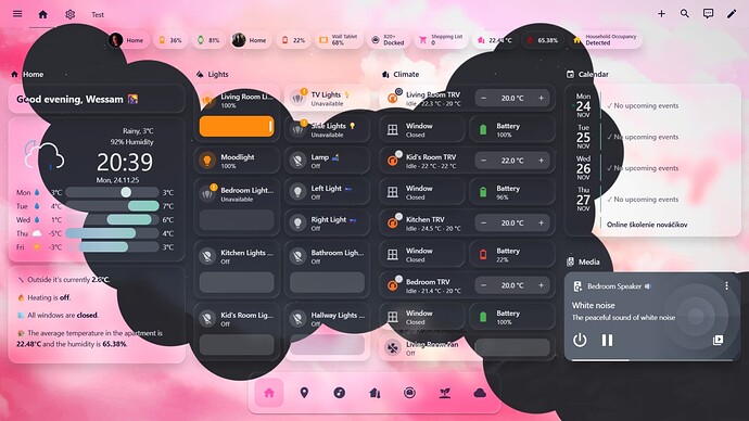

Another issue I noticed. some themes the Glass menu appears clear and scrolling down makes the objects/cards blurry which is what I want. In others however you can see the objects/cards clearly which means the Menu text is now hard to read
This
Vs this
think I prefer the blur since cant read distinguish Menu otherwise
Update:
Ok found solutions for both issues but involves editing each of the themes yaml files.
Thanks to Kaaribou with the above solution for one of them.
HEADER (Top Bar)
app-header-backdrop-filter: ‘blur(8px) saturate(1.1)’ # this entire line needs to be added
DIALOGS
ha-dialog-surface-backdrop-filter: ‘none’ # none works
