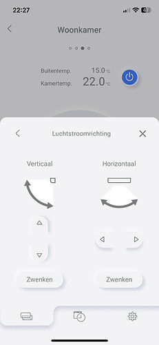

Horizontal swing is still missing for the hass integration

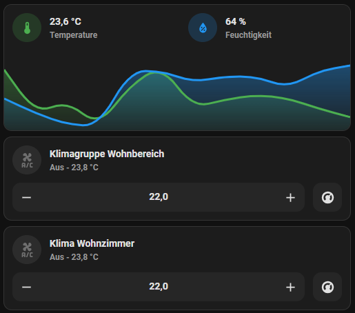

@thesmer can you share the code for your temperature/humity graph please?
(I can’t figure out how to have multiple values on a mini-graph-card assuming that is what you are using)

@gorstj here we go. Actually it is not my code, but I reused and adapted it form one of the “Mushroom threads” in this forum.
The card is a combination of 2 Mushroom cards in combination with the mini-graph-card you mentioned. You can also use the mini-graph-card part without the others.
Let me kown if you need help.
type: custom:vertical-stack-in-card
  - type: grid
    square: false
    columns: 2
      - type: custom:mushroom-entity-card
        entity: sensor.temp_feuchte_display_wohnzimmer_actual_temperature
        primary_info: state
        secondary_info: name
        icon_color: green
        entity: sensor.temp_feuchte_display_wohnzimmer_humidity
        primary_info: state
        icon_color: blue
  - type: custom:mini-graph-card
      - entity: sensor.temp_feuchte_display_wohnzimmer_actual_temperature
        color: var(--green-color)
      - entity: sensor.temp_feuchte_display_wohnzimmer_humidity
        color: var(--blue-color)
        y_axis: secondary
    hours_to_show: 24
    line_width: 3
    font_size: 50
    animate: true
    show:
      icon: false
      state: false
      legend: false
      fill: fade

@glknpn I’m adding horizontal to the todo-list. I don’t own any units with horizontal swing, would you mind helping me with this? DM if you want to!
