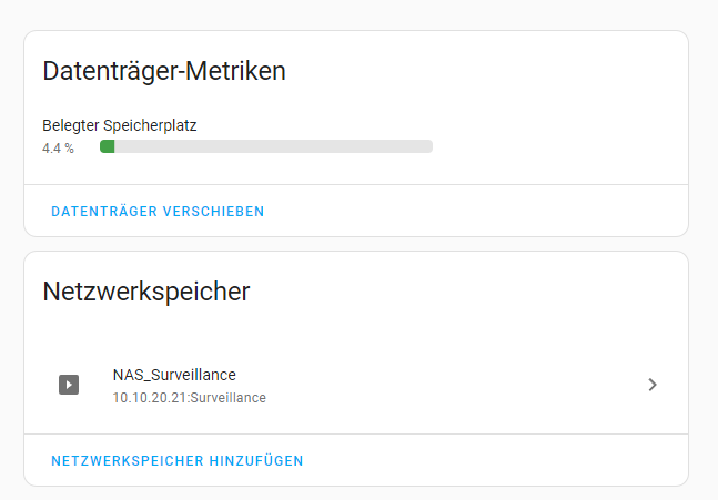

I yesterday connected my NAS as a media folder to include camera recordings.
Unfortunately the full backup creation at night then failed and crashed my whole home assistant os (Pi4B) and I had to reboot it in the morning. Usually the backup is around 200MB, the time when it crashed it was ~6GB. Unfortunately I don’t have any logs due to the restart.
