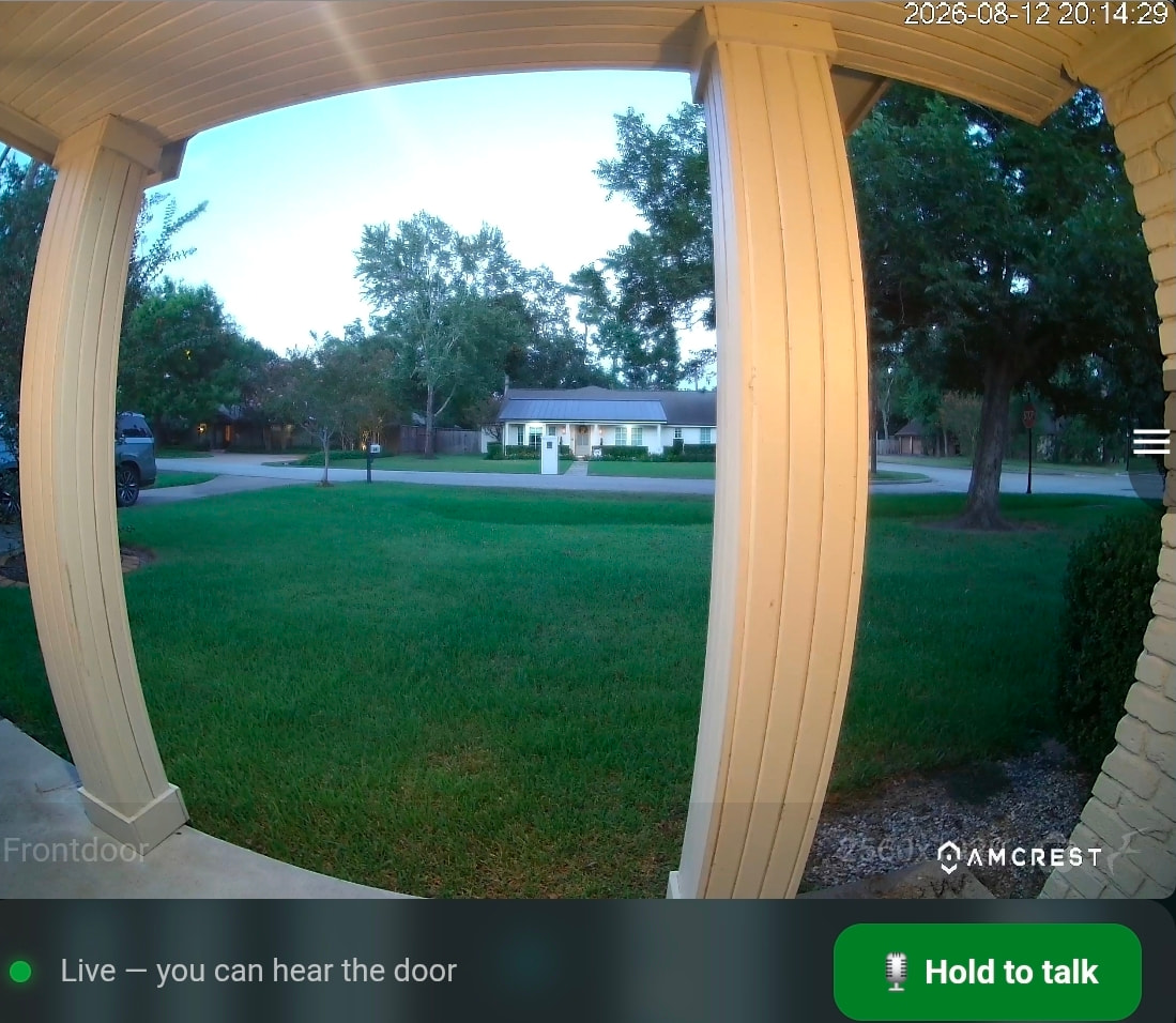

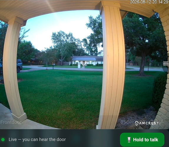

What you get
  • A Supervisor add-on that does the audio bridging (ingress test page included)
  • An example Lovelace card (custom:amcrest-intercom-card): always-on doorbell audio + hold-to-talk, drops in nicely under any live camera card
  • Hear-audio codec is auto-detected (AAC / G.711a / G.711u), so it should work beyond the AD410 — reports welcome
