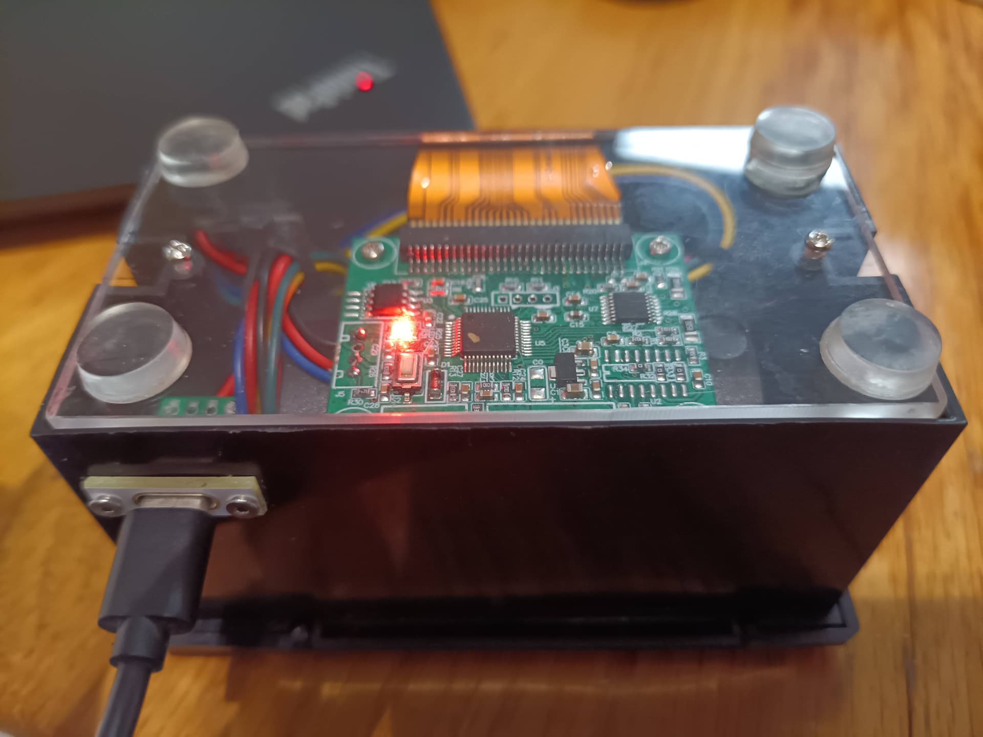

Fully esphome ttl thermal printer
Fully esphome thermal printer!

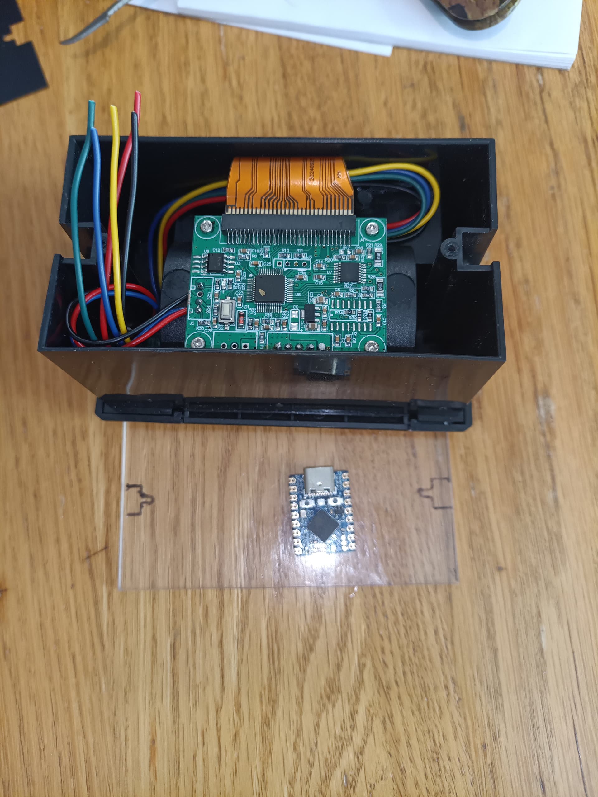

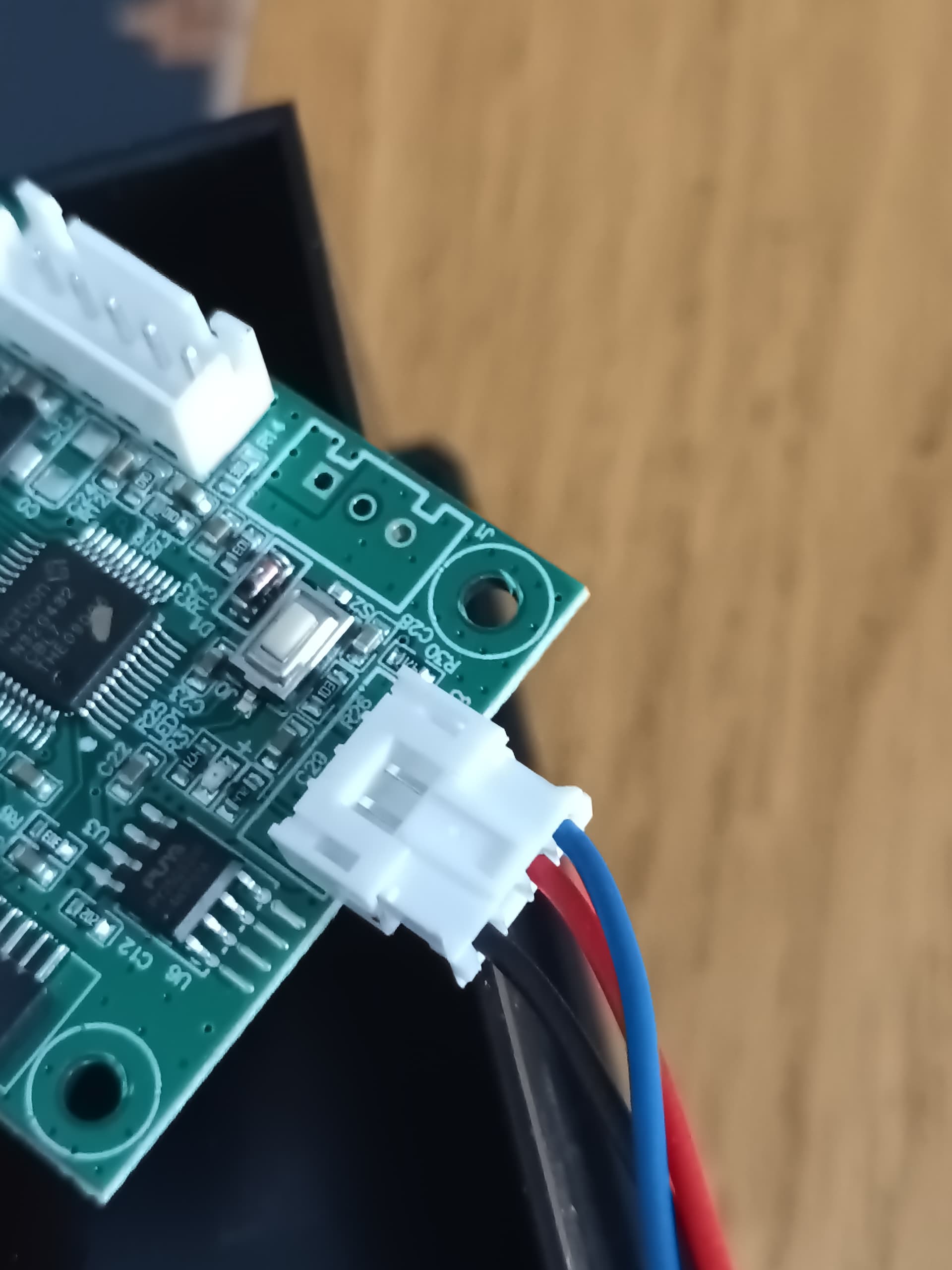

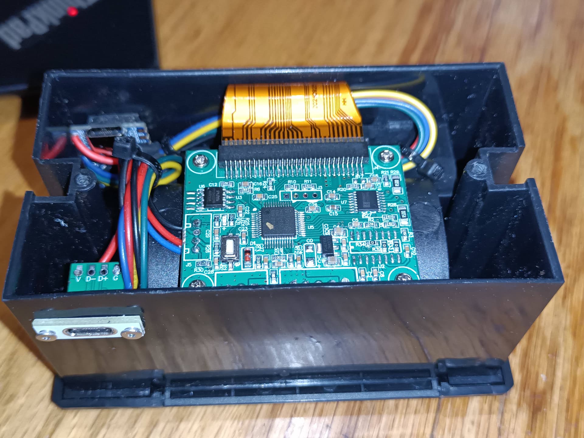

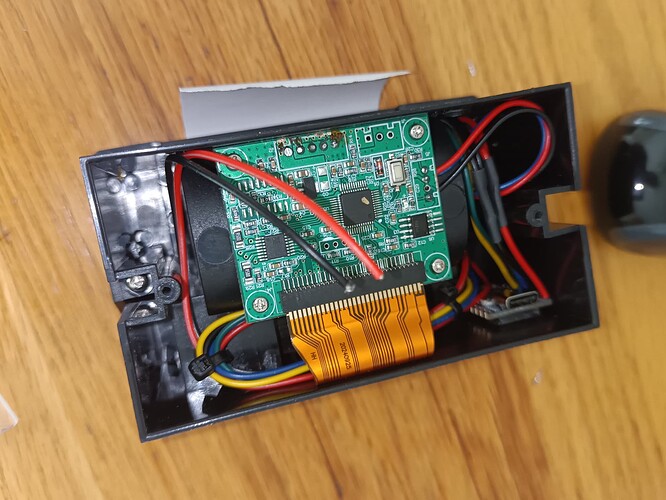

Hardware:
  • 58mm embedded thermal printer, 60mm/s print speed TTL DC 5-9V Print Command: ESC/POS

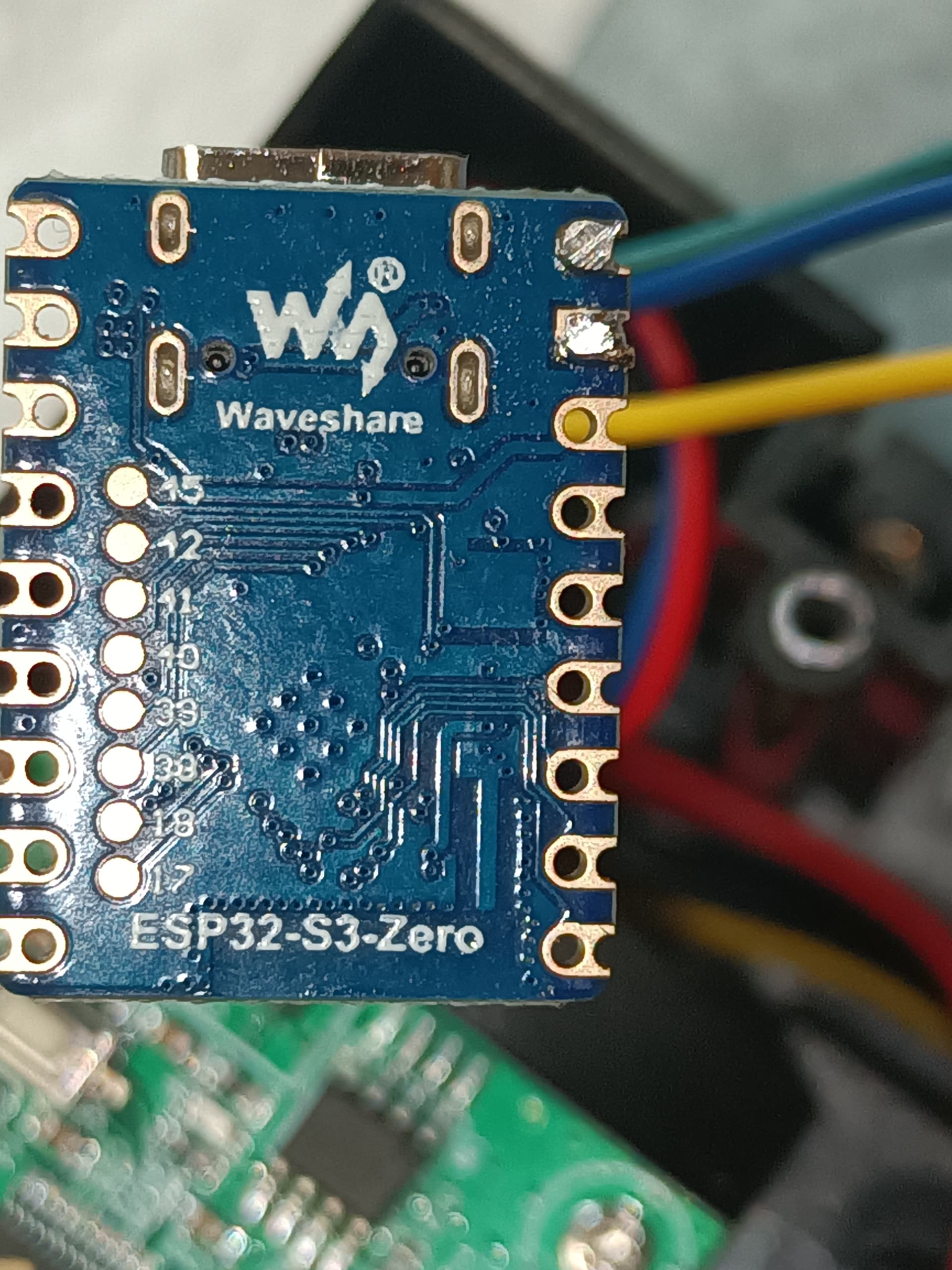

  • Waveshare ESP32-S3-Zero,
  • Screwable USB type C port,
  • Shrink tube,
  • Wires

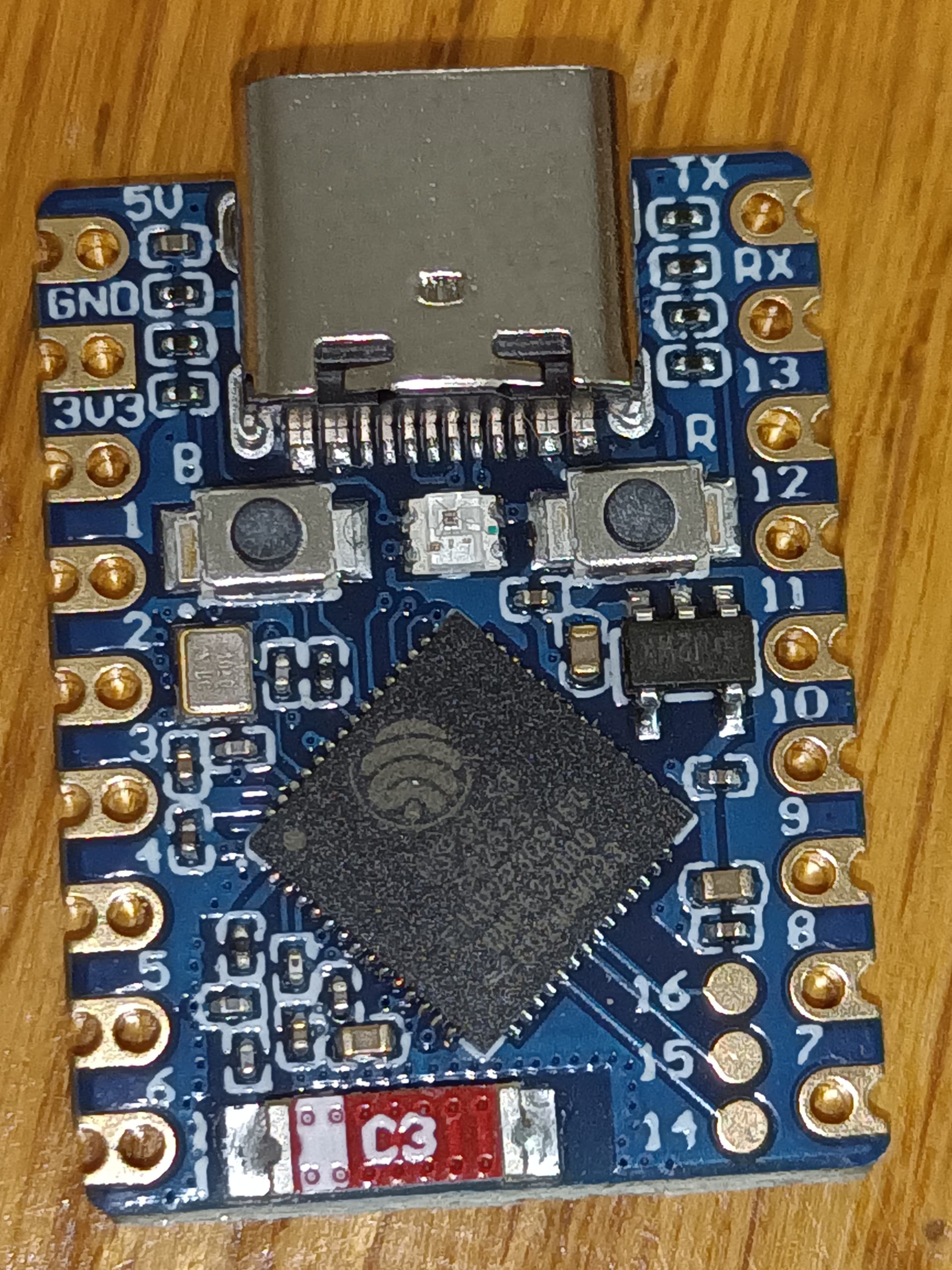

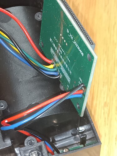

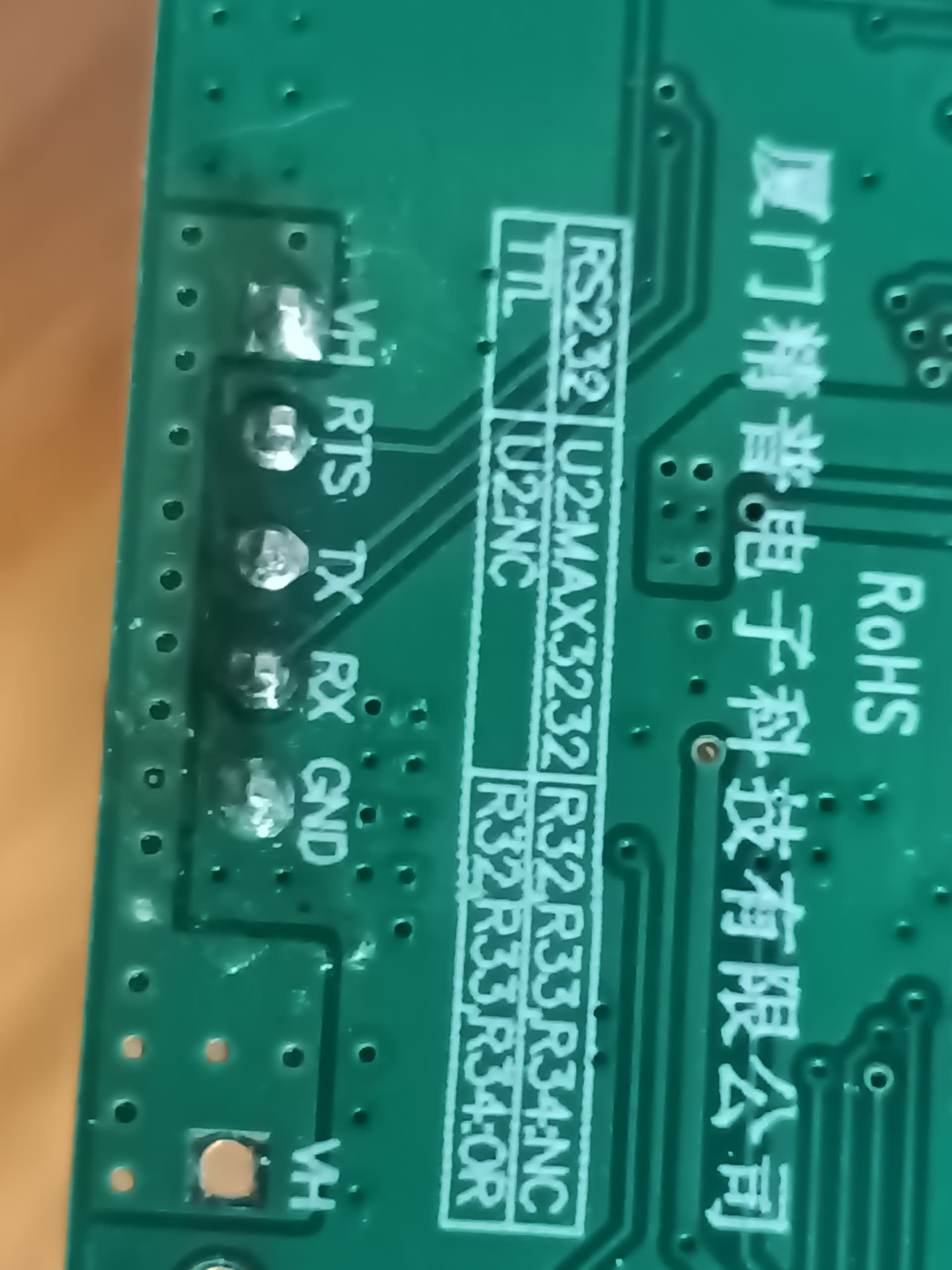

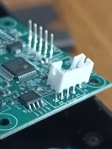

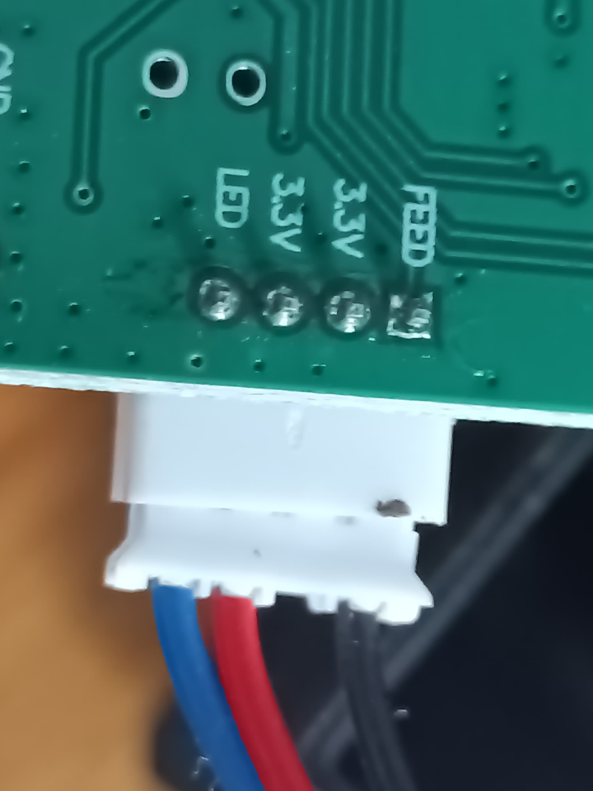

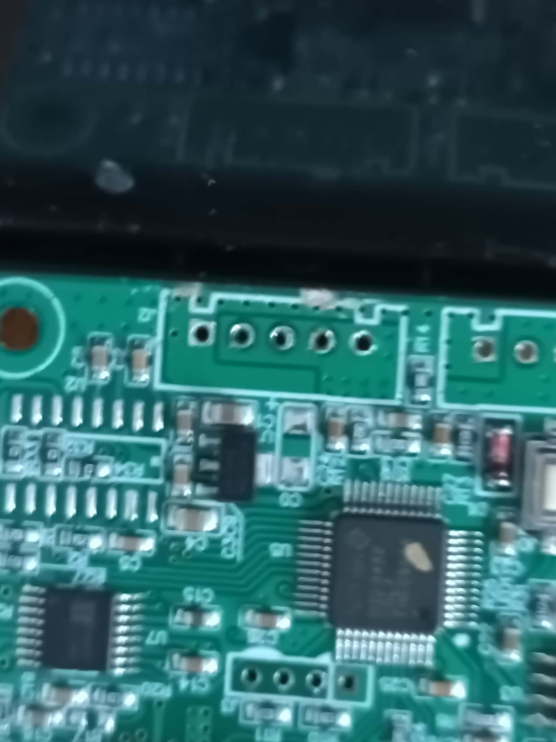

ESP32-C3 Super Mini Printer TTL Description
3V3 VH 5V from usb-c power
GND GND Ground
GPIO1 RX TX ESP → RX Printer
GPIO2 TX RX ESP ← TX Printer
GPIO3 DTR or RST DTR or RST control

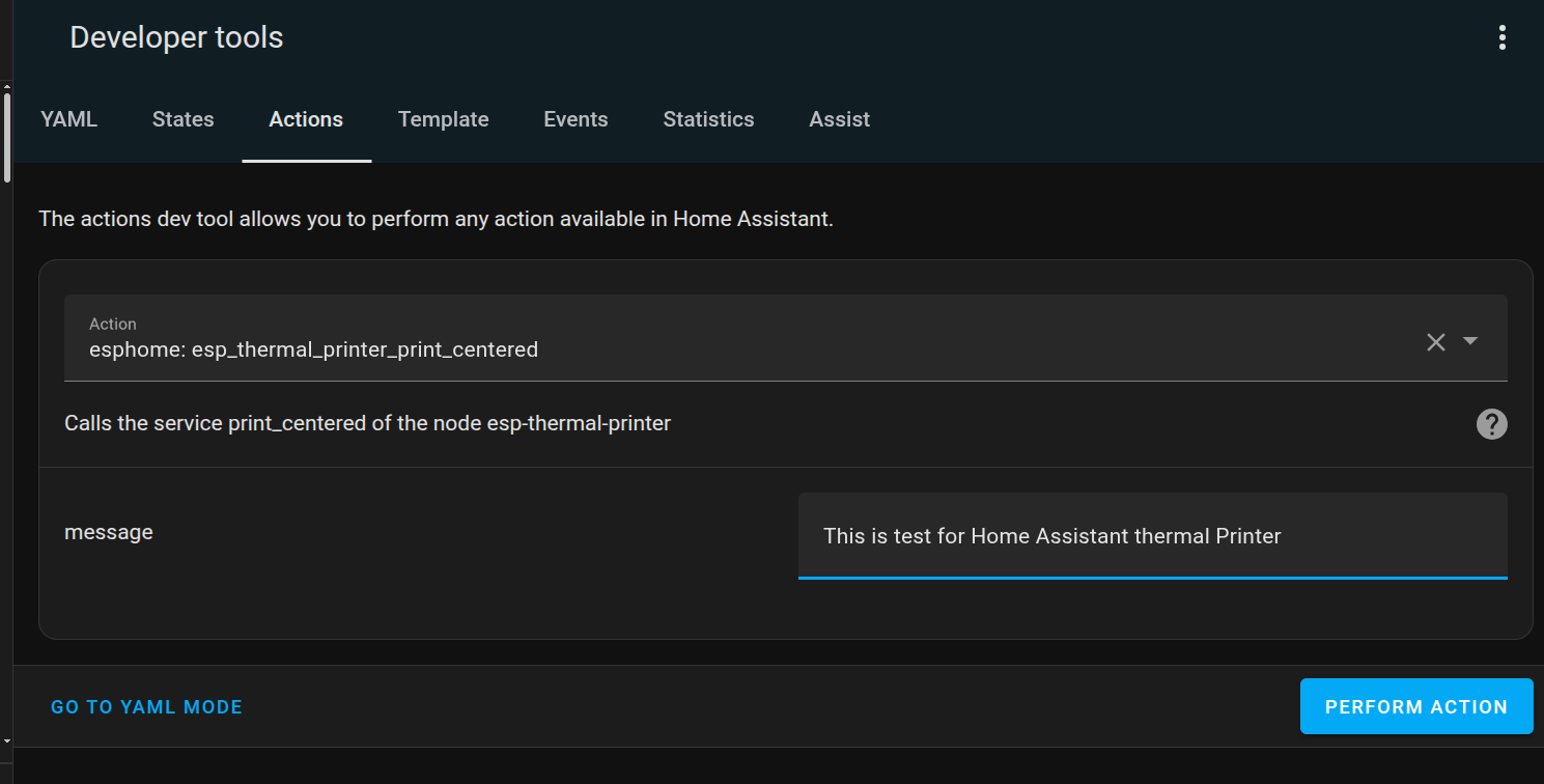

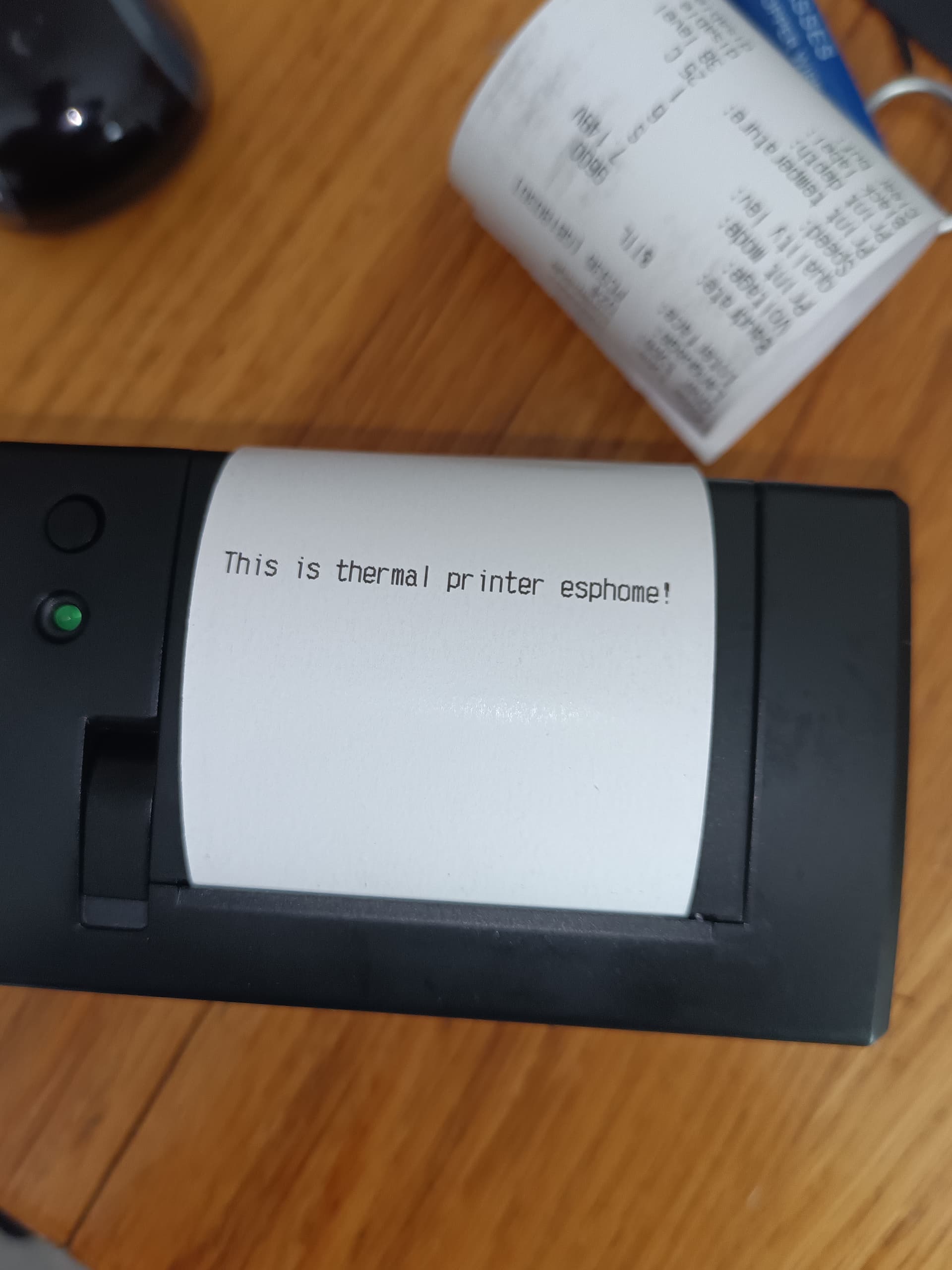

Available Home Assistant Action Commands:
The configuration exposes several custom actions through the ESPHome API that can be called from Home Assistant automations or scripts:
  1. print_text : Prints a simple string of text to the printer. It initializes the printer and adds three line breaks after the message.
  2. print_centered : Prints a string of text centered on the paper. After printing, it returns the alignment to left.
  3. print_large : Prints text using double width and double height characters. It resets the text size to normal after printing.
  4. print_report : Prints a formatted report including a centered, large title, a separator line, content, another separator line, and a centered footer.
  5. print_sensors : Prints a “SENSOR STATUS” title (centered and double width), followed by the current date and time, a separator, and then the provided sensor data.
  6. cut_paper : Sends a command to the printer to perform a partial paper cut, if supported by the printer.
  7. feed_paper : Feeds a specified number of lines.

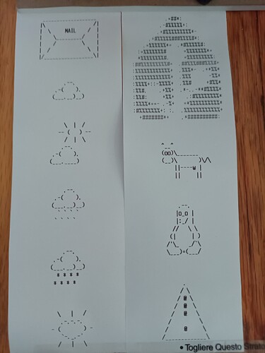

  1. print_ascii_smiley : Prints a predefined ASCII smiley face based on the smiley_type variable. Supported types include “happy”, “sad”, “wink”, and “laugh”. Unknown types default to “:?”.
  2. print_home_assistant_logo : Prints the Home Assistant ASCII art logo.
  3. print_tux : Prints the ASCII art for Tux, the Linux mascot, in bold.
  4. print_cow : Prints a cow ASCII art, in bold.
  5. print_sign_warning : Prints an ASCII art warning sign, in bold.
  6. print_sign_mail : Prints an ASCII art mail sign, in bold.
  7. print_weather_sunny : Prints an ASCII art for sunny weather, in bold.
  8. print_weather_cloudy : Prints an ASCII art for cloudy weather, in bold.
  9. print_weather_rainy : Prints an ASCII art for rainy weather, in bold.
  10. print_weather_snowy : Prints an ASCII art for snowy weather, in bold.
  11. print_weather_partialy_cloudy : Prints an ASCII art for partially cloudy weather, in bold.
