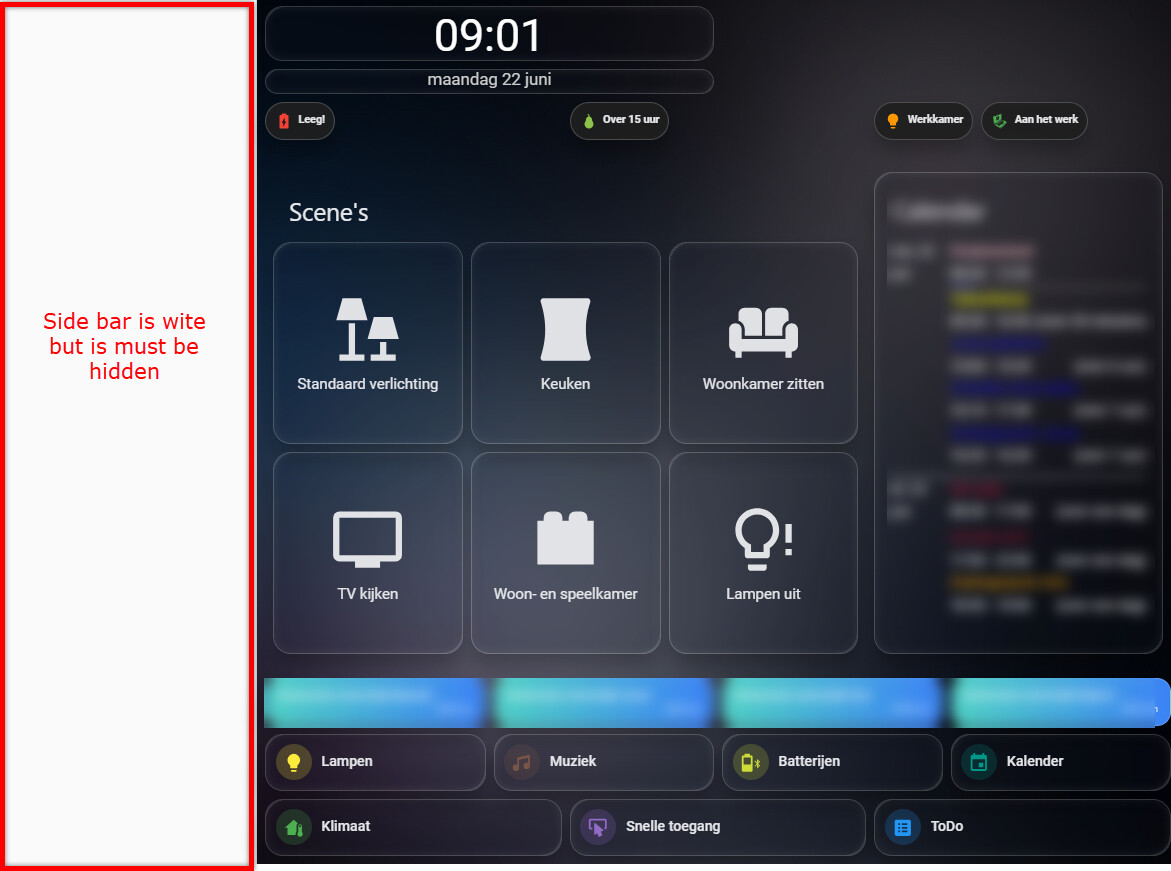

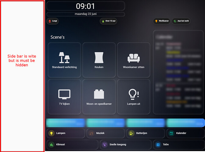

Fully kiosk browser- Wite sidebar
Has anyone an idea?
I have a wite sidebar in my fully kiosk browser.
HASS version 2026.6.2
Fully kiosk version: 13.0.0
i have this problem in my desktop browser and my tablet.
Yaml settings:
kiosk_mode:
  hide_sidebar: false
  hide_header: false
  user_settings:
    - users:
        - Ipad
      hide_sidebar: true
      hide_header: true
  non_admin_settings:
    hide_sidebar: true
Hi @Sandje,
This is Fully-Kiosk home page, and this is kiosk-mode repository. Your configuration is a configuration for kiosk-mode and it is not related in any way with Fully-Kiosk Browser.
You should be referring to [email protected] because the latest version of Fully Kiosk Browser is 1.60.1-play.
Now, if you are in [email protected] and you are using Home Assistant 2026.6.2 it will not work. You can find the reason if you read the release notes of [email protected].
"I did indeed mix up two apps. Stupid of me.
After the kiosk mode update, everything is working properly again and I've lost the white sidebar.
And all that after a clear warning from Kiosk mode​:joy:.
@elchininet; thanks​:+1:
