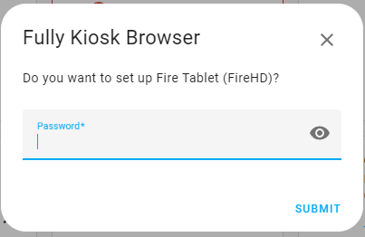

Hi guys,
I struggle to find out which password this could be…
Please guide me in the right direction… thx and cheers
The one you set in fully app on device under remote access…

this is the password you configured on the fully kiosk for the remote administration > remote password
