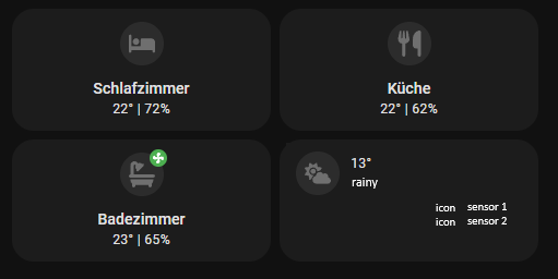

hey guys, could someone help me create a card like the one on the bottom right?
where, if possible, the icon is the weather entity.
