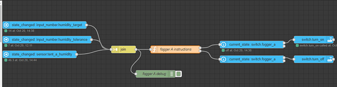

I have my code set up exactly like his word for word with perfect formatting, and when the humidity target goes ABOVE the readouts from the ruuvi tags, the TP link devices turn on just like in the video at the timestamp, but when I drop the desired humidity BELOW the current humidity readouts, the turn_off call service node in the flow is never activated and so the TP links stay on no matter what. I’ve rewritten the code over and over and copied every single thing in the video, but can’t get the darn flow to activate the second call service.
Here is a full picture of the flow, perfectly mirroring the flow in the listed tutorial.

Here are my current state nodes. The “current state is off” node is properly connected to the “turn_on” call service node, and the “current state is on” node is properly connected to the “turn_off” call service node.
And finally here are my call service nodes. As stated before, everything here works perfectly except I can’t for the life of me get the call service “switch.turn_off” to activate no matter what I set my
“input_number.humidity_target” at.
