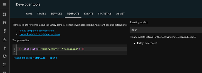

A good way to understand attributes is to use Developer Tools. In there you can see the correct names of the attributes and their actual values for sensors etc in your environment, using the STATES tab.
You can then use the TEMPLATE tab to test your template to expose those attributes:
In Developer Tools | Template, paste this in:
{{ states.zone.home.state }}
{%- for attr in states.zone.home.attributes %}
  {{ attr }}:{{ state_attr('zone.home', attr) }}
{%- endfor %}
Very basic and everyone should have a home zone. If not, go add it!
It will give you an idea of what to see with attributes.
You will see the following attributes:
latitude:
longitude:
radius:
passive:
persons:[]
editable:
icon:mdi:
friendly_name:
The first line is the state of the home zone. That is the number of people (trackable devices) that are in that zone.
The rest is a loop through the attributes of the home zone.
Persons is a list of people (trackable devices) that are home. I think the rest are self-explanatory.
You should get the value you want with a template like this:
{{ state_attr('sensor.NAME_OF_SENSOR_WITH_ATTRIBUTES', 'ATTRIBUTE_NAME') }}
