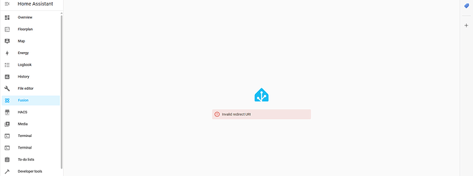

Having issues with HA-Fusion, I logged out of fusion in home assistant, because of issues with editing

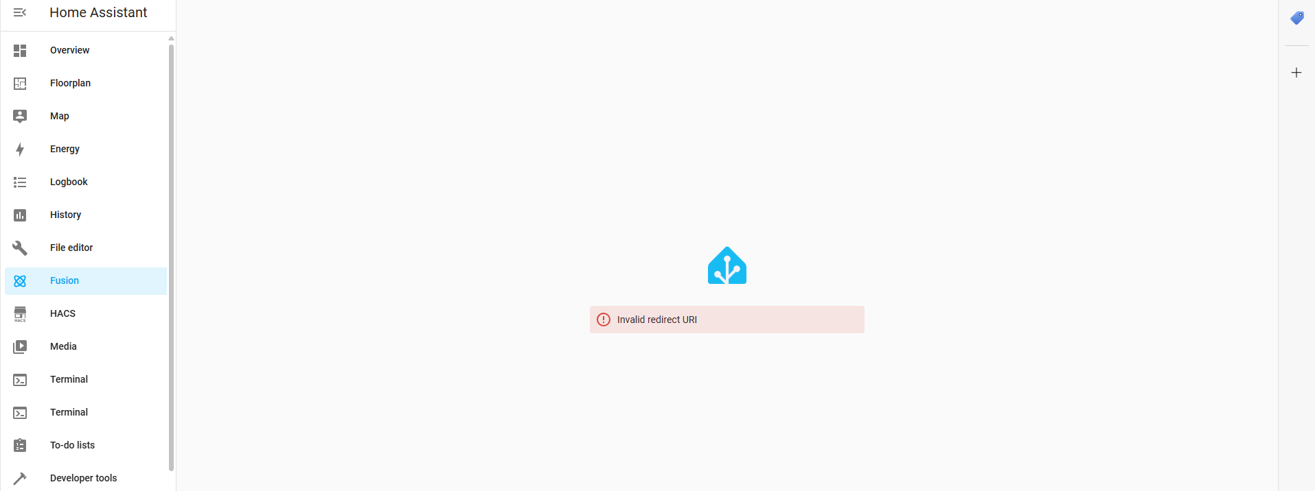

I decided to log out and delete the fusion app, and reinstall it, but now when i try to get into it to re edit it. I get this message.
Try clearing your browser’s cache.
just tried this, still the same issue, I think it has something to do with the yaml for fusion, but I cant locate it.
Did you try rebooting the host, not just ha, after removing before reinstalling? When you choose restart, there should be a drop down on the bottom of the pop up with a reboot host option.
Just tried that as well, still having the same issue. all i did was log out and this happened
This seems to be common on the companion app, do you use it? Can you access it through the mobile app? Here is the issue but there is no real resolution.
that is very odd!!!
I seem to be able to on mobile, also noticed I can access it if i am logged in under a user with non admin privileges.
You might have led me to in the right direction!!! thank you.
It let me use it on the phone, but this time it asked for a long lived access token, which i created, then tried it on mobile and it worked, so then I tried it on the pc that i was having issues with, and that also work :rofl:,
