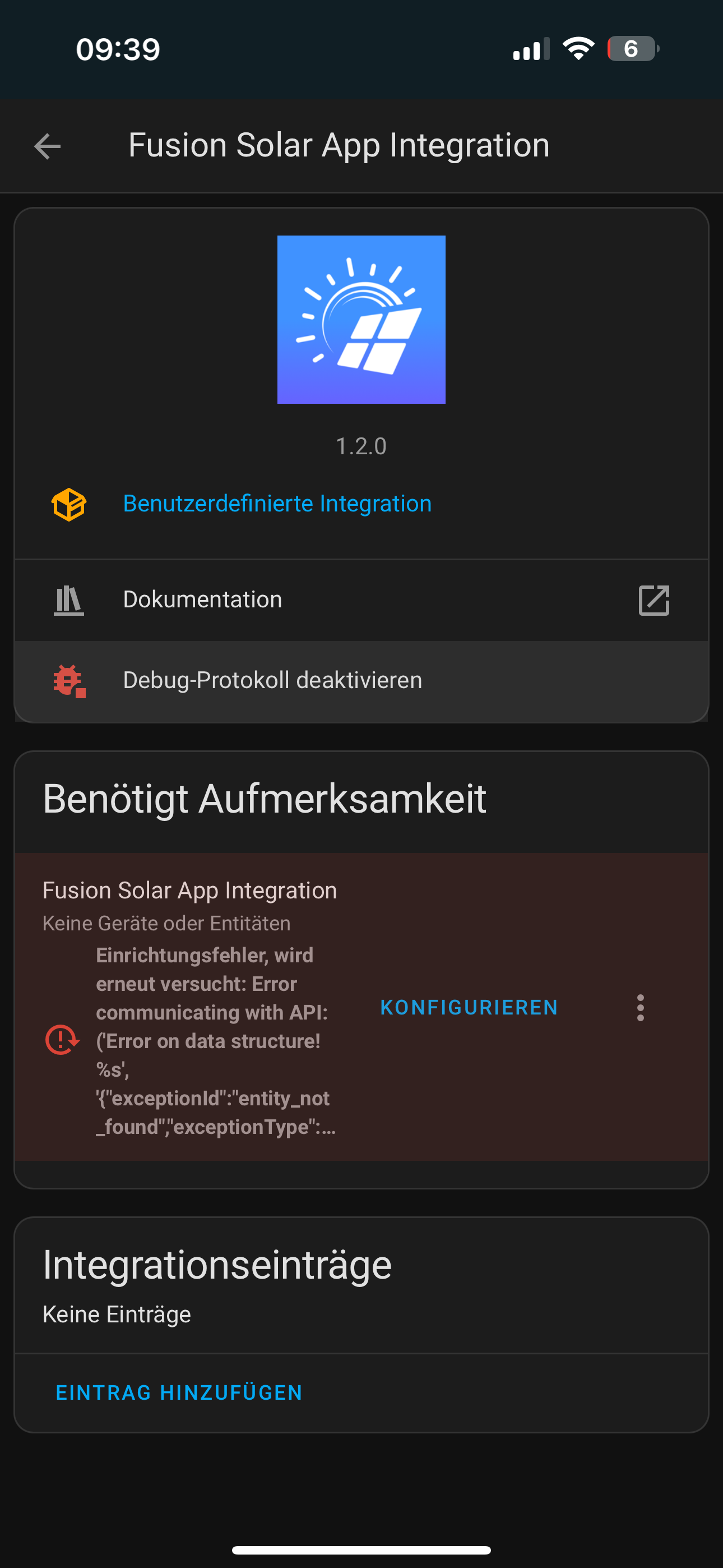

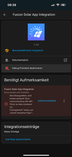

Hi, I tried installing the Fusion Solar App integration. Authenticaton with my fusion solar account seems to work just fine but I get this error message:
Logger: custom_components.fusion_solar_app.coordinator
Quelle: custom_components/fusion_solar_app/coordinator.py:83
Integration: Fusion Solar App Integration (Dokumentation)
Erstmals aufgetreten: 08:58:14 (37 Vorkommnisse)
Zuletzt protokolliert: 09:42:09
(‘Error on data structure! %s’, ‘{“exceptionId”:“entity_not_found”,“exceptionType”:“ROA_EXFRAME_EXCEPTION”,“descArgs”:null,“reasonArgs”:null,“detailArgs”:null,“adviceArgs”:null}’)
Any idea how to solve this?
