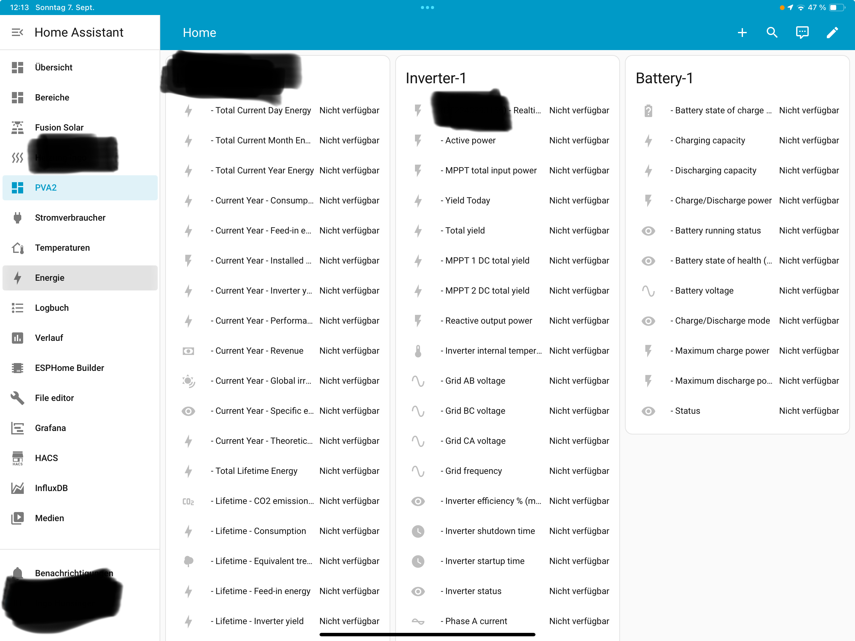

After tonight’s update on fusion solar it doesn’t work anymore on HA. I had an openApi config and northbound config.
Is anyone else going through the same issue??

After the Update HA “Sigenergy ESS” doesn’t work anymore!
