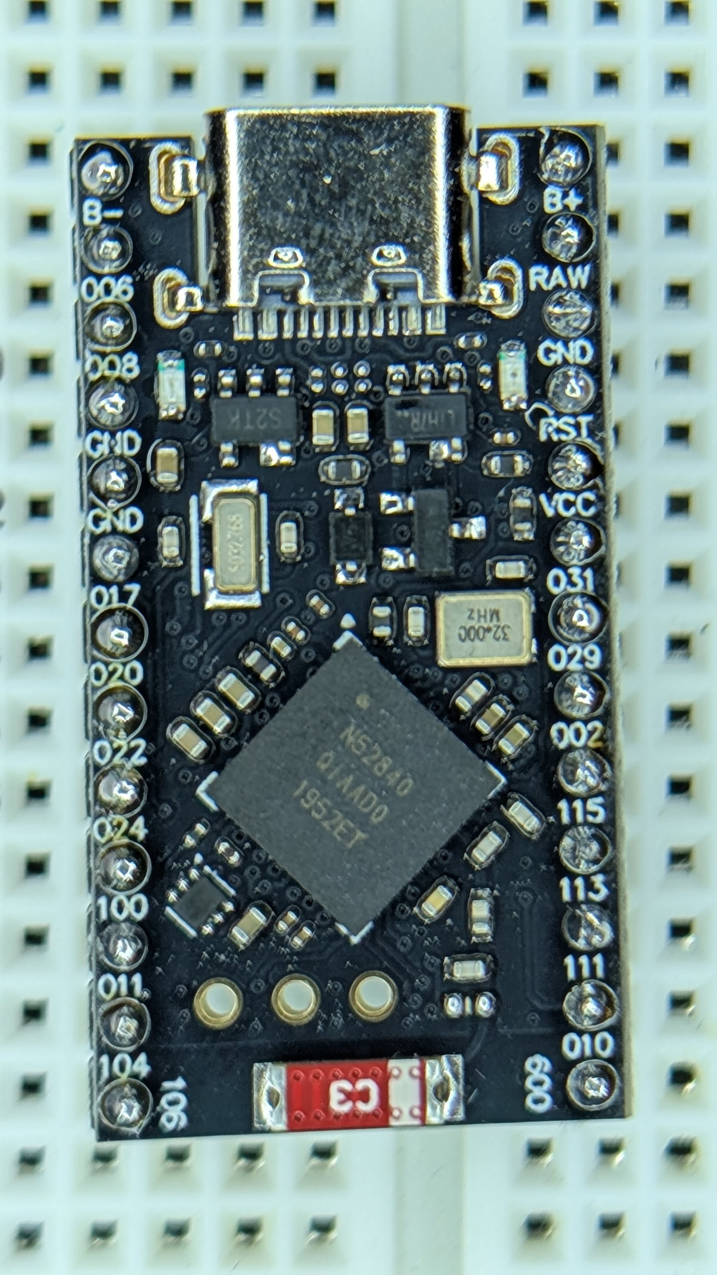

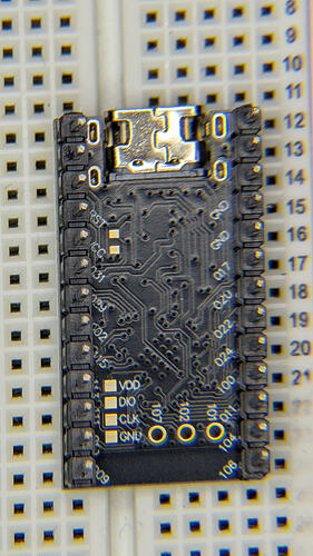

Do others guess what these are?
probably that one, but there are many it could be
it seems to be closest to this IstyBitsy board. Looks like this:

That board is Nice!Nano clone, commonly called "ProMicro" or "SuperMini".
It usually comes with Adafruit bootloader. Be careful not to update wrong bootloader, that will soft-brick it.
Here you can get more info about your board.
https://github.com/joric/nrfmicro/wiki/Alternatives#pro-micro-compatible
