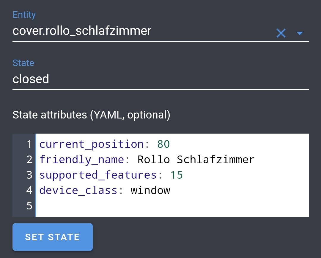

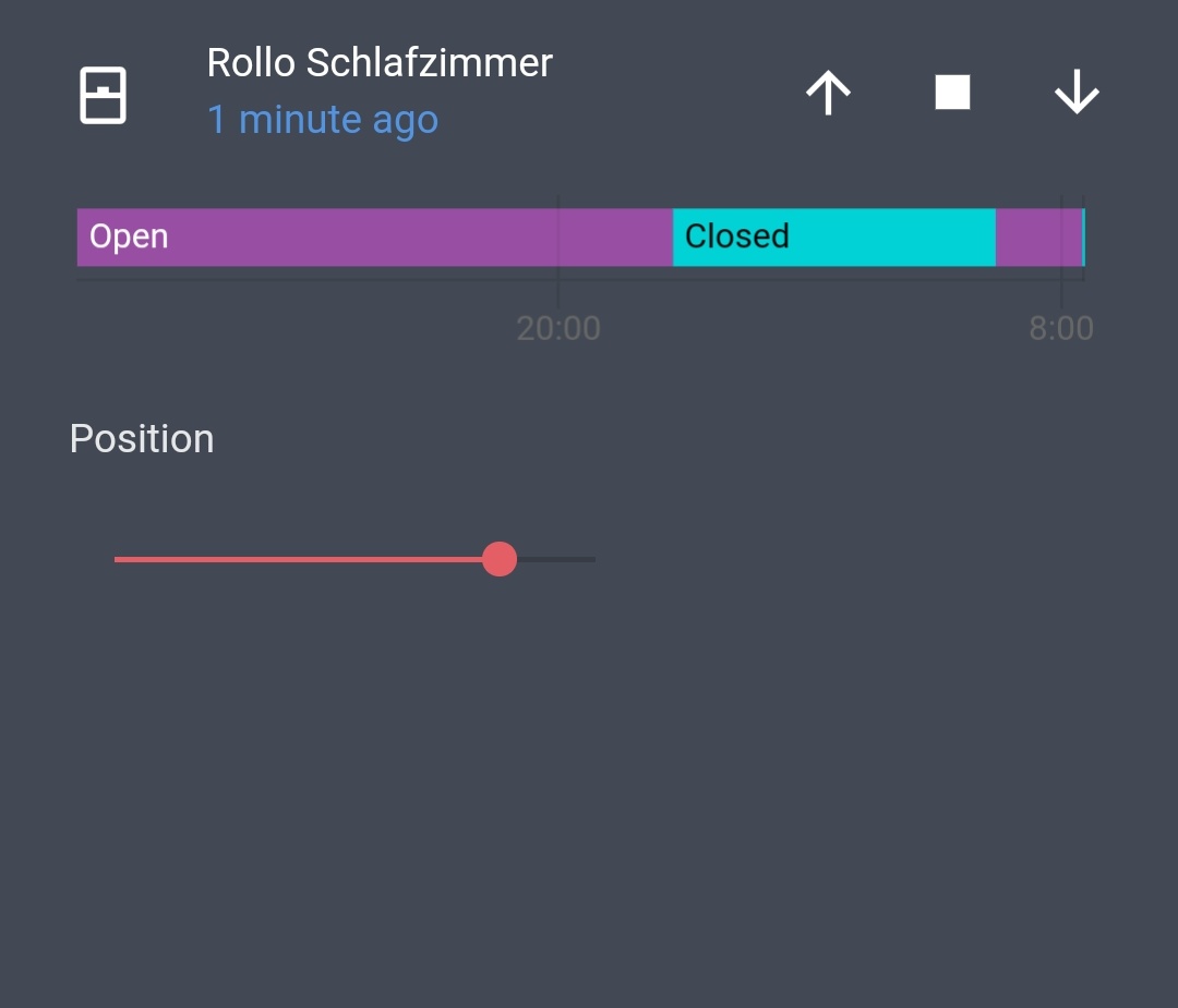

If i set the blind state with the slider:
48
If i reload the page:
15
State (current position) is not updated:
58
I have tried to unpair and pair the cover several times…
