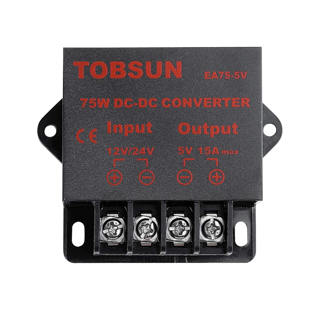

I have tried with a 12v to 5v 10A regulator,

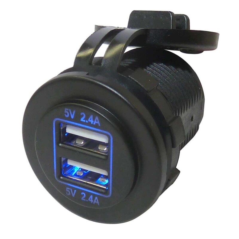

And have also now tried with a 12v USB socker adaopter as shown below, none of these methods work.
I have tried cutting the Male USB-A end off and wiring into these adapters, aswell as leaving the cable intact incase cutting the cable is causing issues with full current charge. Nothing seems to work.
Iâm honestly out of ideas at this point, I donât know why this tablet will not charge.
