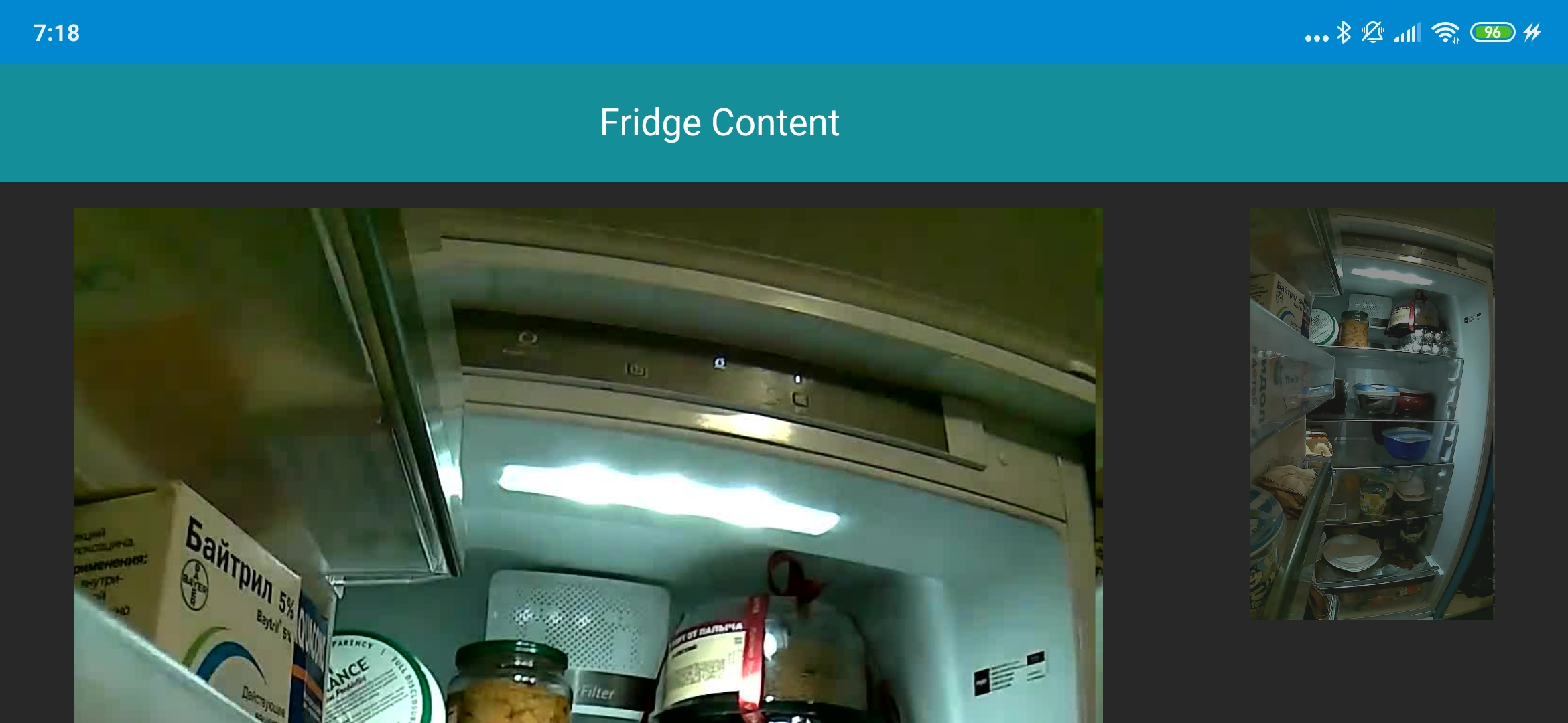

I use it for looking at photos of my fridge - very helpful during shopping
Photos are vertically oriented and there are small problems with it.
Some suggestions:
- remove Sub Title from Panel completely - I had to comment it out completely
- could you limit main menu-viewer picture by height of window? Horizontally oriented view is not good with vertical photos (pic 1)
- and decrease height of preview photos a little bit (labels are not visible for previews) - if you do this changing photos in the phone will be smooth - without scrolling. (pic 2)

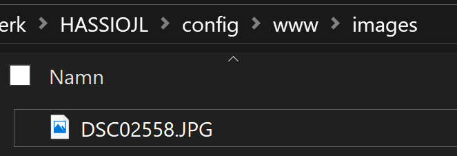

So this is exactly what I have been looking for! So excitet to get it up and running but for some reason I’m failing getting a sensor up and running. As I understand it I should be able to find a entity called “gallery_images” under Configuration > Entities?
Should be pretty straight forward to get this up and running so what am I doing wrong, any ideas?

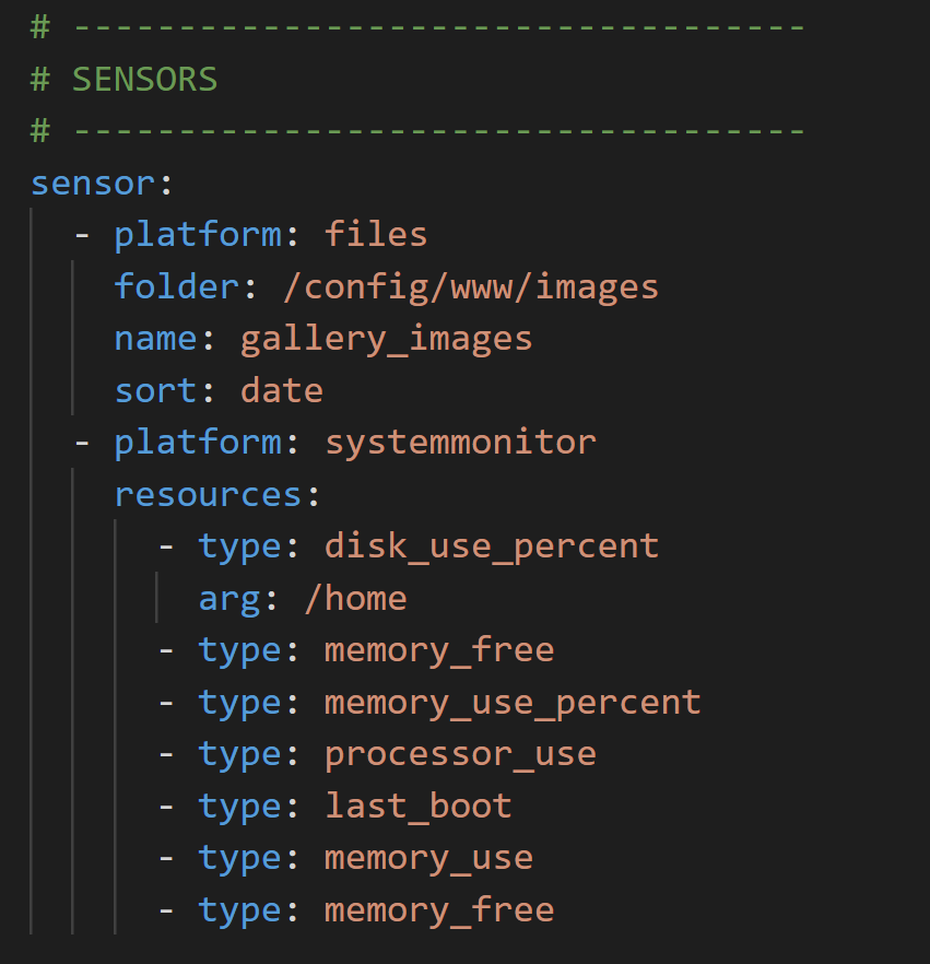

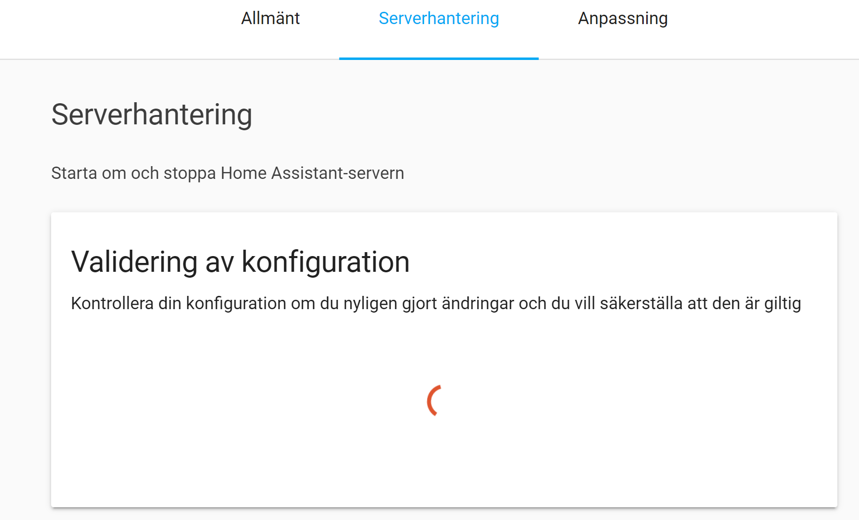

So move things around and when I add the “Gallery panel” code under sensors the “Validate config” action (before restarting) just spins forever (sorry for the language). As soon as I remove it the configuration is validated within a second:
Strange. One thing I just checked, it does not appear under Configuration -> Entities, but does appear under Developer Tools -> States. I’m not sure why.
But there seems to be something else going on if your config will not validate. It also appears from your config that you are on a new version of hass. So I’m a little stumped.

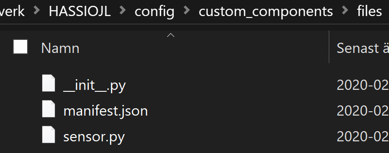

Do you have other things under custom_components? If not, maybe verify that your permissions are good there.
Thanks for looking into this!
I have other components, hacs and sia, in that folder and they work fine.
What is also strange is that if I delete all other sensors I sometimes get the validation of the configuration through but it also looks like it depends on where in configuration.yaml I put the sensor.

Thanks, I will look into it. But the page where I validate my config actually doesn’t give an error. it is just spinning and “validating” forever.
