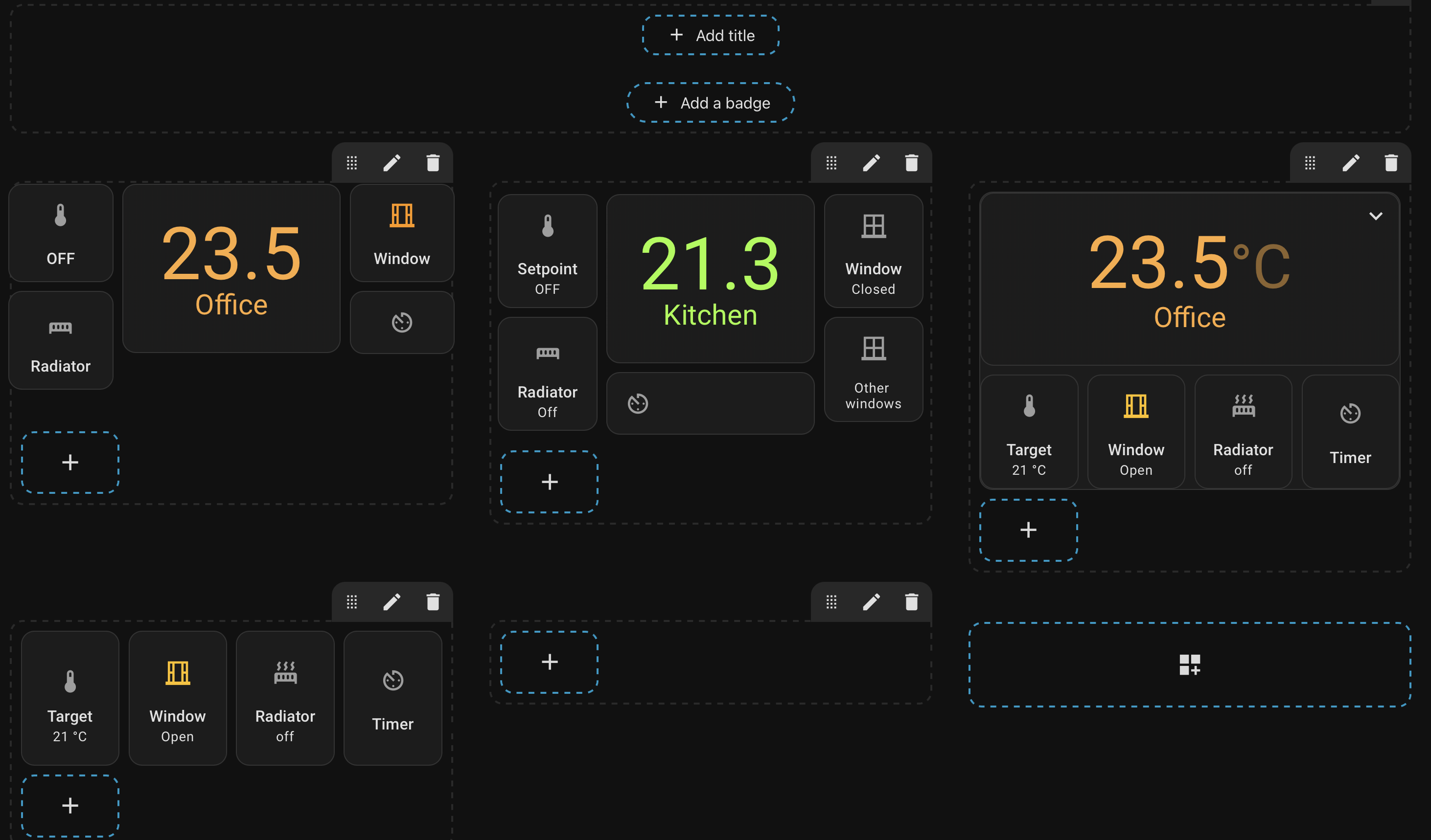

Are you using the new Sections view type? Or are your screenshots from Masonry? I’m seeing the same issue as @Mirro66 in that the height of a row is set to the height of the highest card - and cards don’t collapse where they can to fit. For example, it looks like either Office could fit under Tech, or Hallway could fit under Office.
Everything looks good at mobile viewports (since there’s only one column), but I’m not seeing a way to create a good looking dashboard at desktop-width viewports.
For example, in this case it would work much better if Outside went under Basement, so then the “lights on” auto-entity card would have more height to work with.

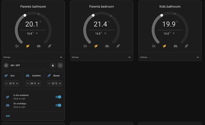

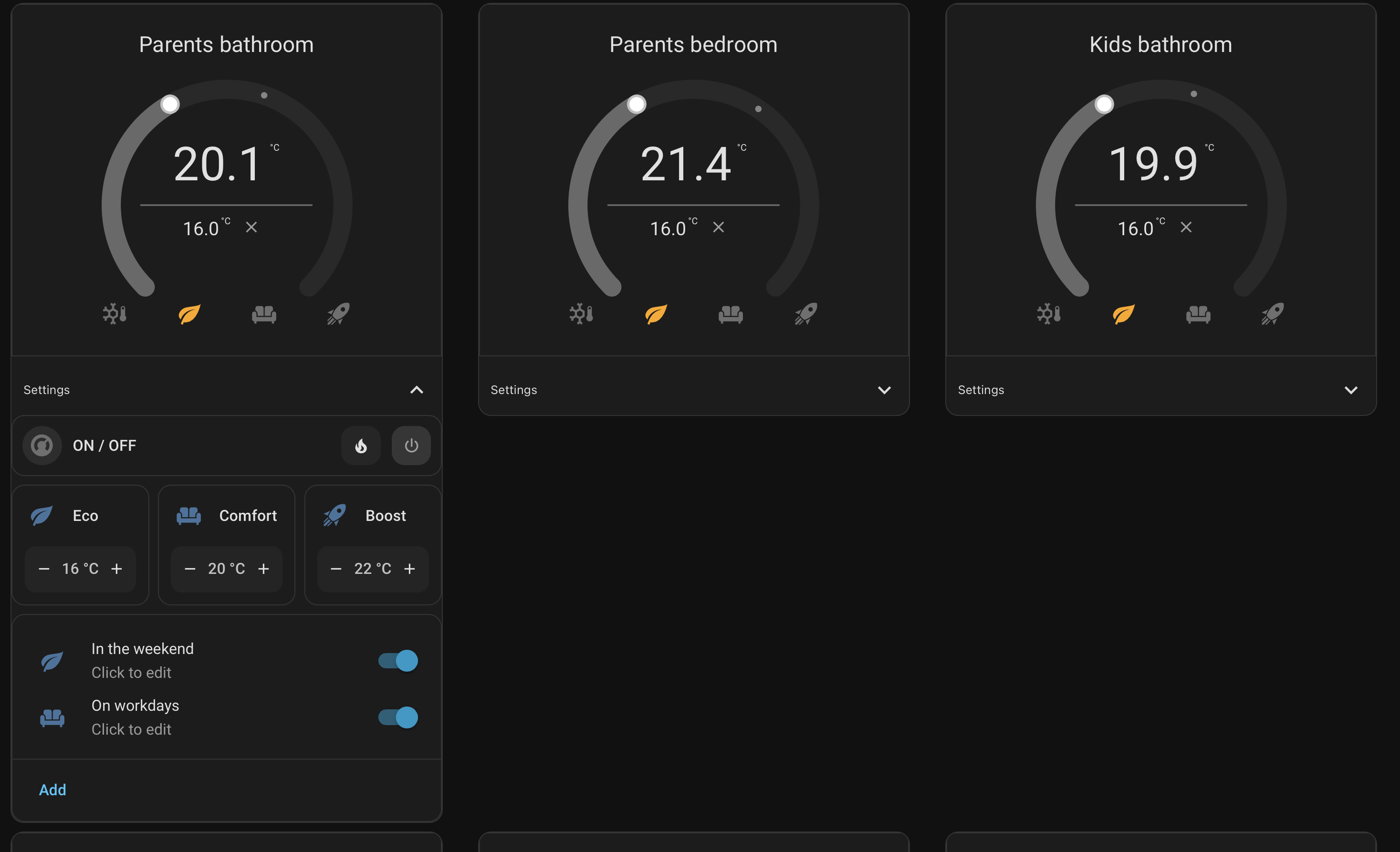

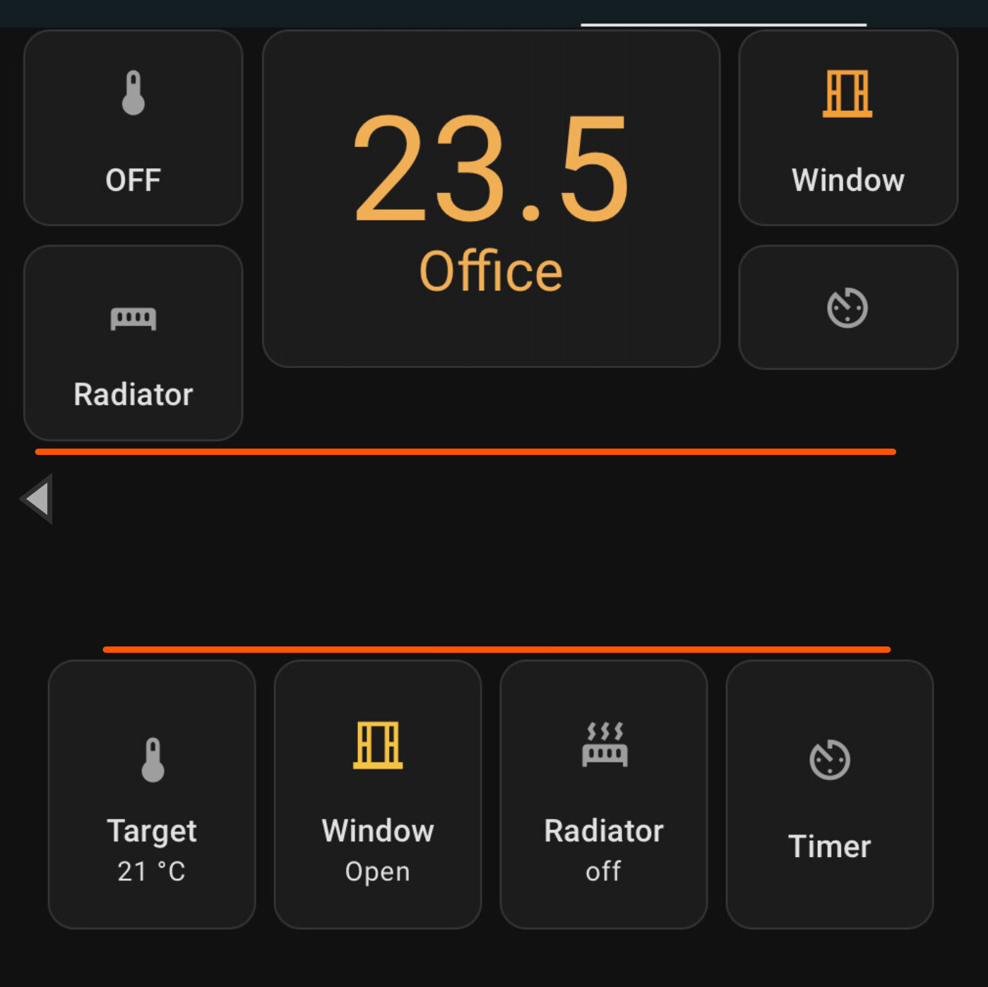

Guys, me and OP are refering to that:
Show a screenshot in edit mode please.

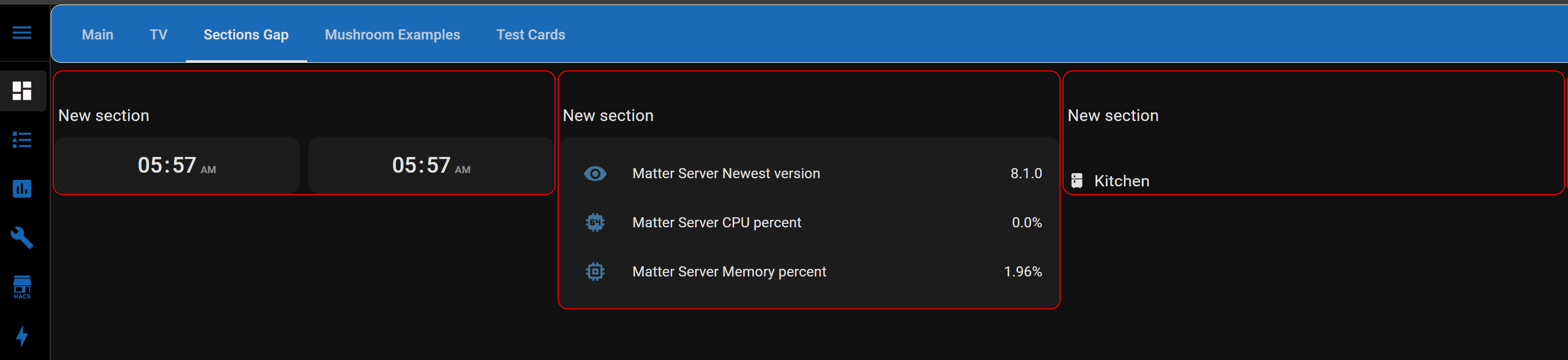

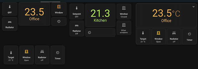

ok, here are few examples. I don’t have a perfect example of how annoying it is because I was avoiding that layout … but here we go.
So I understand, this gap ( between the red lines) is an example?
yup
BTW, I think second screenshot demonstrates it better.
