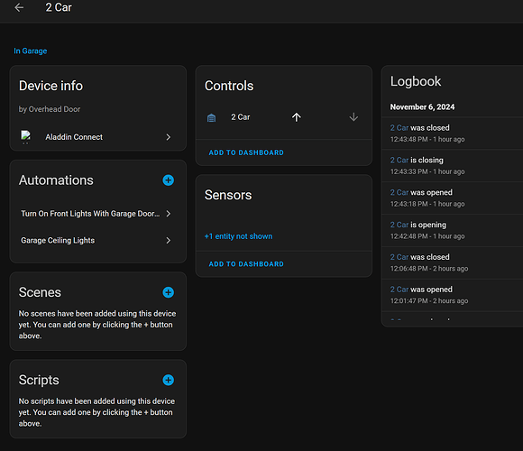

Also, here is a log of the most recent opening and closing of the door it that helps.

I have an automation that runs every 30 minutes that reloads the devices so that it grabs the current status of the door. I think it doesn’t get the status automatically when it changes so I just reload it.
