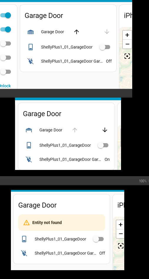

It’s an older thread, but with the deprecation of legacy templates I have run into an issue with my implementation.
This is what I have been using until now, which is based on above (and has been working great).
# Garage door
cover:
  - platform: template
    covers:
      garage_1:
        device_class: garage
        friendly_name: "Garage Door"
        value_template: "{{ is_state('binary_sensor.garage_door_sensor_input', 'on') }}"
        open_cover:
          service: switch.turn_on
          entity_id: switch.shellyplus1_01_garagedoor_switch_0
        close_cover:
        icon_template: >-
          {% if is_state('cover.garage_1', 'open') %}
            mdi:garage-open-variant
          {% else %}
            mdi:garage-variant
          {% endif %}
Modern Configuration, as provided by (HASS) Template
template:
- cover:
  - device_class: garage
    open_cover:
    - entity_id:
      - switch.shellyplus1_01_garagedoor_switch_0
      action: switch.turn_on
    close_cover:
    - entity_id:
    default_entity_id: cover.garage_1
    icon: "{% if is_state('cover.garage_1', 'open') %}\n  mdi:garage-open-variant\n{%
      else %}\n  mdi:garage-variant\n{% endif %}"
    state: '{{ is_state(''binary_sensor.garage_door_sensor_input'', ''on'') }}'
Unfortunately, while the garage door Shelly is still responding, the suggested update causes an "Entity not found’ error - see bottom pic in screenshot (to top/middle one are from the old code.)
Any suggestions on how to fix it?
Here is what will continue to work:
template:
  - cover:
      - default_entity_id: cover.garagedoor1
        unique_id: GarageDoorID1
        state: "{{ is_state('binary_sensor.ecolink_garage_door_sensor_1_sensor_state_any', 'on') }}"
        icon: >-
          {% if is_state('binary_sensor.ecolink_garage_door_sensor_1_sensor_state_any', 'on') %}
          {% else %}
            mdi:garage-variant
          {% endif %}
        open_cover:
          - action: cover.open_cover
              entity_id: cover.garage_door_1
        close_cover:
          - action: cover.close_cover
        stop_cover:
          - action: cover.stop_cover
