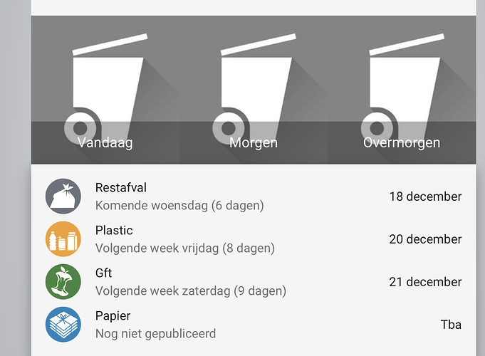

preparing the move to Saver (still fingers crossed this component will be able to d so too…) I figured to download their icons
and adjust the card with those.
they are .svg files however, and we can not upload them here
So this is only to say that instead of what we are used to
we can now use those .svg’s directly, resulting in
or
ofc just as an example, those 3 should not be the same for these types ofc in reall life schedules.
I also added them as custom icons to the entities, but those look really bad, they’re not typically designed to the Material guidelines. better use the builtin mdi icons for that still

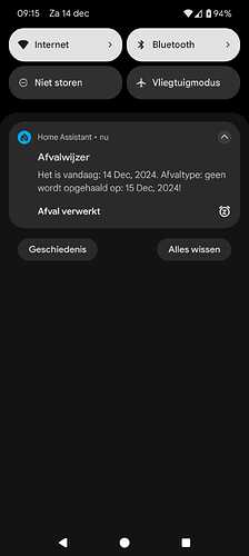

Since the new update I get a message every day that the waste is being collected, this also happens with “no” waste.

Hmm, maybe it has something todo with case sensitive stuff, could be a bug. I see in your notification “geen” in lowercase, while the template says “Geen”. I’ll have a look at the code Tomorrow as well.
This I mean. So you get a notification indeed every evening then since trash geen is being picked up almost every day then ![]()
Just checked. When configuring the component, if you fill in “Geen” as a default label instead of the default label “geen”, then it should work fine again.
I have now reinstalled the integration, I could not change the data in the config flow, it just stayed on “geen”. After reinstalling I could fill in “Geen”. Will have to wait until tomorrow after 18:00 if the message is indeed gone.
