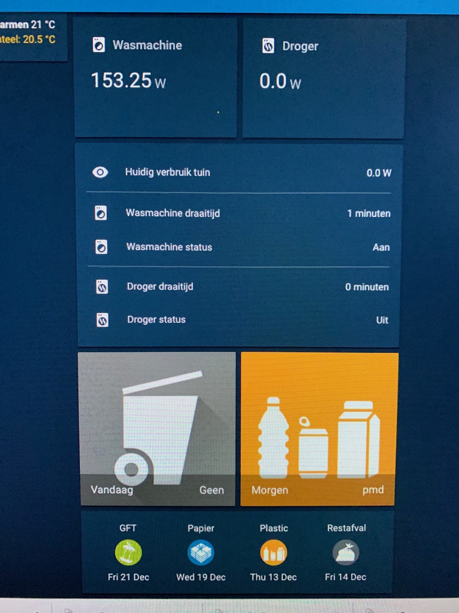

Nice indeed, changed the setup a bit to keep them all together: a vertical stack with a nested horizontal stack.
btw 1 anomaly…:
large icon for plastic is so wrong!.. spot the error, and difference with my other original:
plastic (and I dont refer to the resolution )
14
  - type: vertical-stack
    cards:
      - type: horizontal-stack
        cards:
          - type: picture-entity
            entity: sensor.trash_today
            state_image:
              'gft': /local/mijnafvalwijzer/gft3.png
              'papier': /local/mijnafvalwijzer/papier3.png
              'restafval': /local/mijnafvalwijzer/rest3.png
              'plastic verpakkingsafval': /local/mijnafvalwijzer/plastic3.png
              'Geen': /local/mijnafvalwijzer/kliko3.png
            entity: sensor.trash_tomorrow
            state_image:
      - type: custom:useful-markdown-card
        content: >
         Vandaag is het <font color='green'>[[ sensor.vandaag.state ]]</font>.
      - type: glance
        entities:
         - entity: sensor.gft_formatted
         - entity: sensor.papier_formatted
         - entity: sensor.plastic_verpakkingsafval_formatted
         - entity: sensor.restafval_formatted
Enlighten us? The large one is correct (PlasticBlikMelkpakken)…
Is there a way to het the date translated? Is there a route to localisation in HA?
I am going to deploy the stacks more, just used it for the first time yesterday…
Cheers,
Kees
well, this illustrates the fact ā€˜experts’ don’t agree how garbage should ultimately be disposed of and collected…
The modern waste-factories can separate waste much better and more precise, than we do manually at this moment.
But, in our neighborhood we have to collect Plastic, separate of everything else, and ā€˜blik’ should be disposed of together with the small and final waste fraction of Rest…
It is all about politics… Oosterhout and Breda both transport their waste to the factory at Moerdijk. Breda collects plastic while Oosterhout PBM including metal coated plastics. We can even leave foodleftovers in plastic. It al depends on the contract each municipale signed and what the local policies are…
Thanks for pointing it out! Now I see what I did wrong.
Localization is done by setting the language of your interface.
The date format can be adjusted by adding the ā€˜datumformaat’ attribute to the sensor settings.

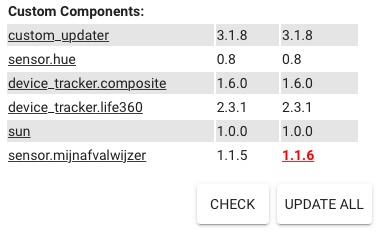

HI @xirixiz
please check the release page, the 1.1.6 isn’t listed, so updater won’t update…
30
Fixed…thanks!
cool.
doesn’t help though, updater still lists the same for your component…which is in fact not yet updated.

hey @xirixiz
would you please update the correct version info in your GitHub repo? Updater says 1.1.6 is available but isn’t successful in updating.
Checking your repo the files are still on 1.1.5?
15
Hi Marius…fixed :smiley:

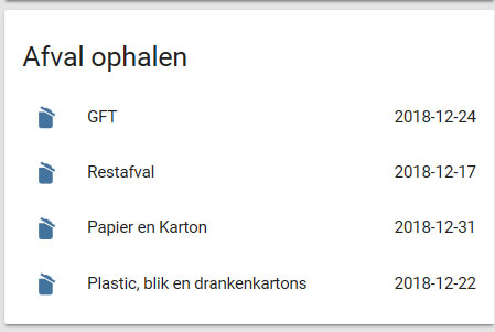

trying to find a way to count the days left for the next collection date (see Bin / Waste Collection)
the other component uses:
import datetime
import bin_collection_dates
from datetime import *
    today = date.today()
    future = bin_collection_dates.next_collection
    diff = future - today
    days_left = str(diff.days)
    print(days_left)
which is of no use (yet), but might be when adapted somehow?
maybe you can help? Right now im using the extra scrape sensor for afval_datum, but that doesn’t return a timestamp, but a string.
