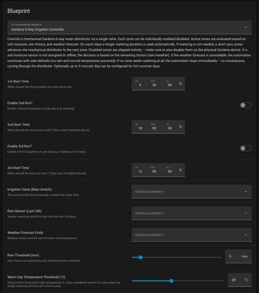

Smart irrigation blueprint for the Gardena 6-way mechanical water distributor –
the valve that advances to the next zone by pressure release (water off → water on).
:droplet: What it does
This blueprint controls all 6 zones sequentially through a single smart valve/switch.
For each zone it decides based on sensor data whether to water at full duration,
use an extended duration on hot days, or just send a short sync pulse to advance
the mechanical distributor.
:sparkles: Features
Feature Description

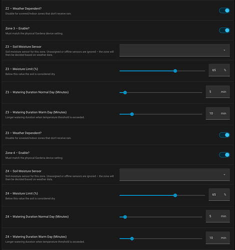

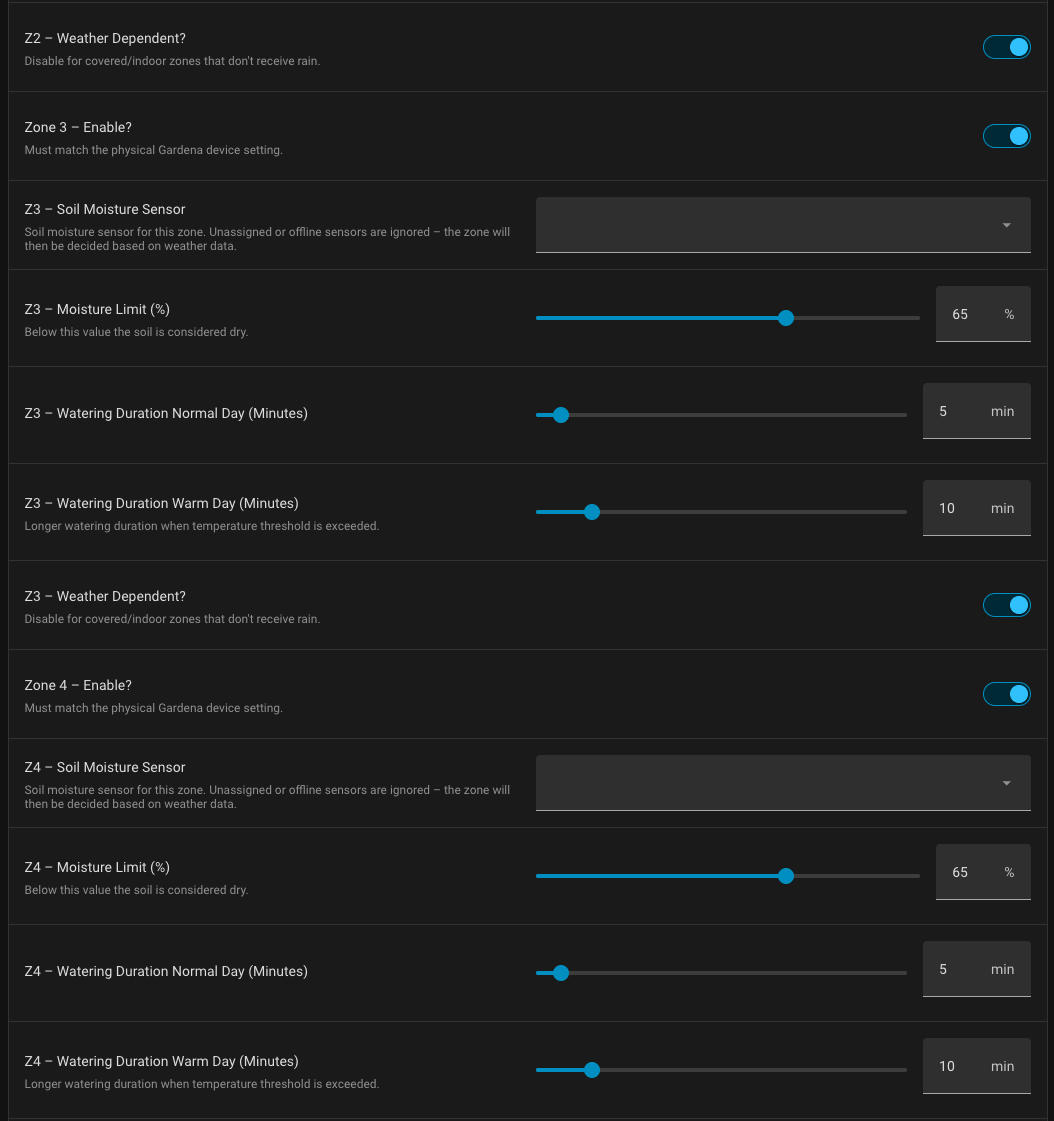

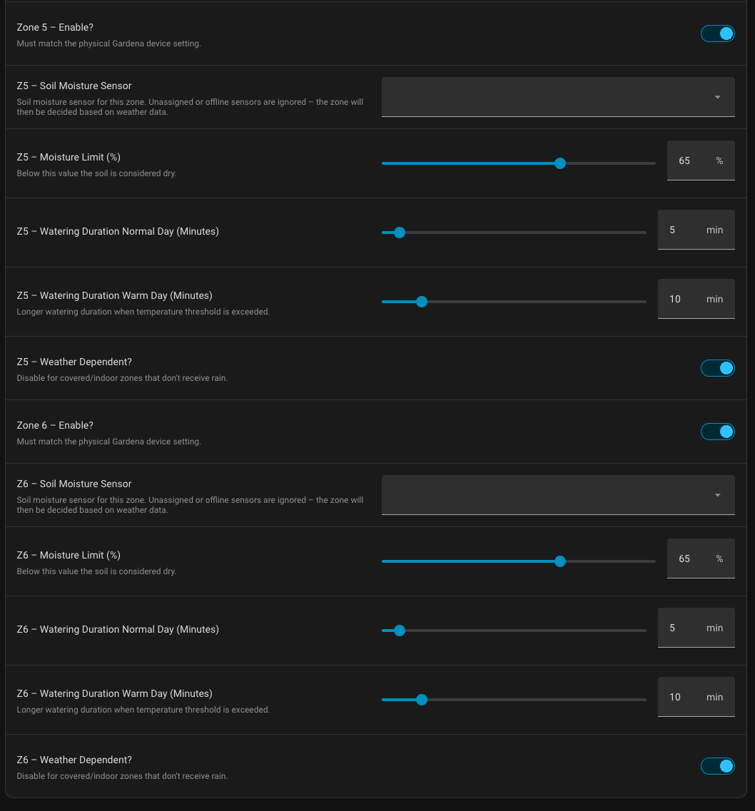

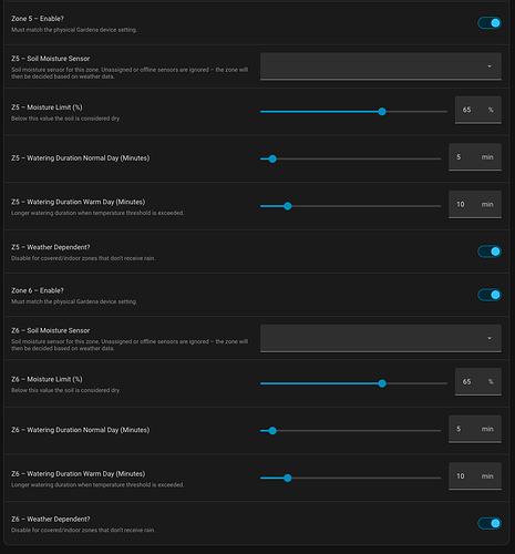

:thermometer: Soil moisture monitoring Per-zone – only waters when the soil is actually dry
:cloud_with_rain: Rain history check Skips watering if it rained enough in the last 24h
:sun_behind_cloud: Weather forecast check Skips watering if significant rain is predicted
:fire: Temperature-aware watering Automatically uses longer watering duration on hot days
:house: Weather dependency toggle Per zone – disable weather checks for covered/indoor zones
:gear: Zone enable/disable Deactivated zones are skipped entirely (must match physical device)
:counterclockwise_arrows_button: Automatic sync pulses Zones that don't need watering still advance the distributor
:wrench: Configurable timing Adjust sync pulse duration and pressure release pause
:shield: Sensor offline resilience Offline sensors don't block watering – weather data decides
:shield: Weather service resilience If forecast is unavailable, safe defaults are used

:clipboard: Changelog – Gardena 6-Way Irrigation Controller
Version 2.0 (2025-05)
:new_button: New Features
  • :repeat_button: Multiple Runs Per Day
    Up to 3 configurable start times per day. Perfect for hot summer days
    when morning-only watering isn't enough. 2nd and 3rd runs are optional
    and disabled by default.
  • :fire: Temperature-Aware Watering
    Two watering durations per zone: normal day and warm day. The blueprint
    automatically selects the longer duration when the forecasted high
    temperature exceeds a configurable threshold (default: 28°C).
  • :next_track_button: Smart Skip (Pre-Check)
    Before starting the zone loop, the automation checks if ANY zone
    actually needs water. If none do, the entire cycle is skipped instantly –
    no unnecessary sync pulses, no valve wear, no wasted time.

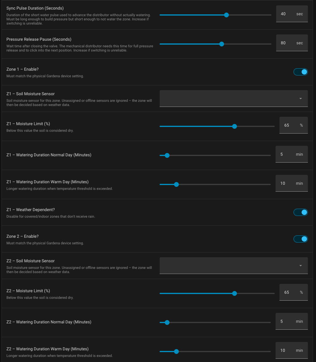

  • :wrench: Configurable Mechanical Timing
    Sync pulse duration (default: 40s) and pressure release pause (default: 80s)
    are now configurable inputs. Allows users to optimize timing for their
    specific water pressure and pipe setup.
:shield: Reliability Improvements
  • Weather Service Resilience
    If the weather forecast service is unavailable (e.g. no internet),
    the automation continues with safe defaults: no rain assumed (0 mm),
    normal temperature assumed (20°C). Uses continue_on_error: true to
    prevent the entire automation from failing.
  • Sensor Offline Handling
    If a soil moisture sensor goes offline (unavailable/unknown), the zone
    is treated as "dry" and the remaining factors (rain history, weather
    forecast, weather dependency) decide whether to water. Previously this
    could block watering entirely.
  • Rain History Pre-Calculation
    Rain history sensor is now read once before the loop instead of
    per-zone, reducing unnecessary sensor queries.
:counterclockwise_arrows_button: Technical Updates
  • Modern Forecast API
    Replaced deprecated state_attr(weather_entity, 'forecast') with
    the current weather.get_forecasts service and response_variable.
    Required since Home Assistant 2024.3+.
  • Updated Service Syntax
    Changed service: to action: throughout, matching current
    Home Assistant YAML conventions.
  • Trigger Variables Block
    Added trigger_variables section required for conditional trigger
    enabled fields (used by optional 2nd/3rd runs).
:memo: Configuration Changes
Parameter v1.0 v2.0
Start times 1 fixed Up to 3 (2nd/3rd optional)
Watering duration 1 per zone 2 per zone (normal + warm)
Temperature threshold – New (default: 28°C)
Sync pulse duration Fixed 40s Configurable (default: 40s)
Pressure release pause Fixed 80s Configurable (default: 80s)
Weather fallback Automation would fail Safe defaults + continue
Sensor offline Could block watering Treated as dry
Smart skip – New pre-check
:warning: Migration Notes
  • No breaking changes – v1.0 configurations continue to work
  • New inputs use

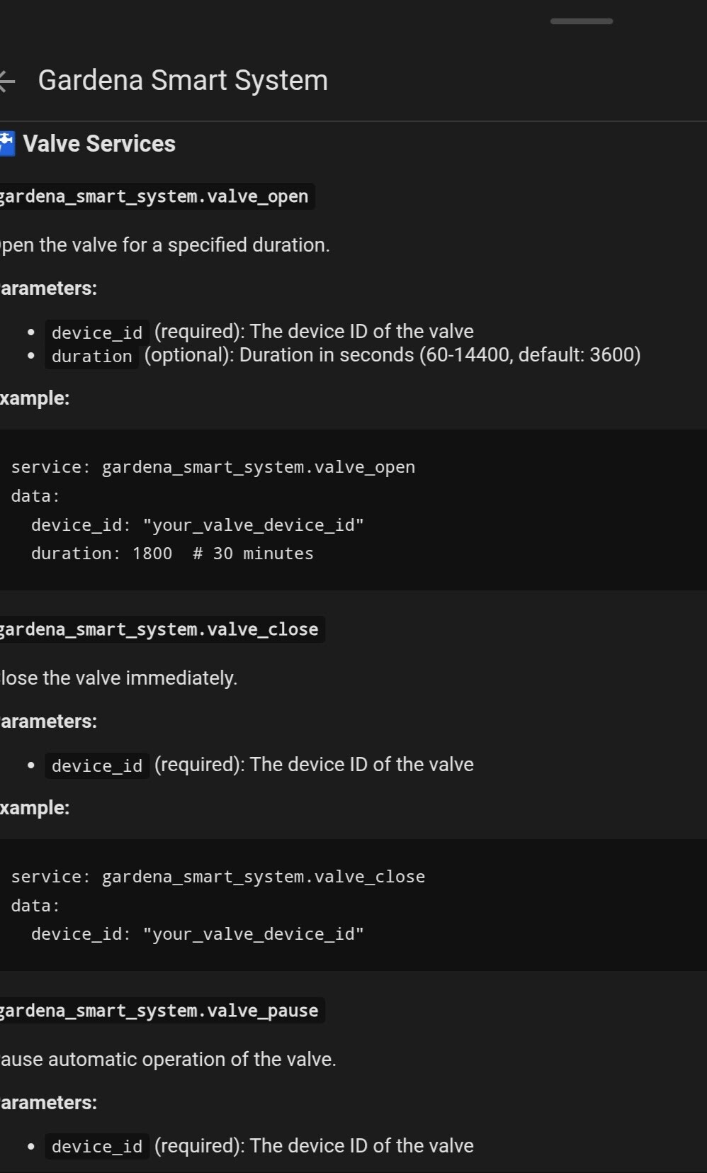

Thanks! I tried something similar a few days ago, yours looks way better.
I have one problem: I cannot find my Gardena water control valve because it is not saved as a "switch". What can I do?
Thank you in advance!
:counterclockwise_arrows_button: Update v2.1 – Valve Entity Support
Based on community feedback, the blueprint now supports both switch and valve entities for the main irrigation control.
What changed
  • The entity selector now accepts switch.* and valve.* entities
  • All service calls changed from switch.turn_on/off to homeassistant.turn_on/off
  • This automatically calls the correct service depending on your entity type
Why this matters
Some integrations (e.g. Gardena Smart System) expose the water control as a valve.* entity instead of a switch.*. Previously, these couldn't be selected in the blueprint configuration.
How homeassistant.turn_on/off works
Entity Type Service Called Automatically
switch.my_valve switch.turn_on / switch.turn_off
valve.gardena_water valve.open_valve / valve.close_valve
No configuration needed – it just works! :sparkles:
Migration
  • No breaking changes – existing switch.* configurations continue to work
  • If you have a valve.* entity: Simply re-open your automation config and select your valve entity from the dropdown

@tuehna Great news – I just pushed v2.1 which adds native support for valve.* entities! :tada:
What to do:
  1. Re-import the blueprint (or reload blueprints under Developer Tools → YAML)
  2. Open your automation configuration
  3. You should now see your Gardena valve entity in the dropdown
The blueprint now uses homeassistant.turn_on/off which automatically detects whether your entity is a switch or valve and calls the correct service.
No workarounds needed anymore – just select your valve and you're good to go! :+1:
Let me know if it works for you.
Unfortunately it did not work. I don't know why. I found this in the hacs documentation of the integration, see attachment, it says for example:
service: gardena_smart_system.valve_open data:
device_id: "your_valve_device_id"
duration: 1800
30 minutes
Maybe that's why it did not work?
Thanks for sharing the documentation – that explains the issue! :+1:
The Gardena Smart System HACS integration uses custom services (gardena_smart_system.valve_open/close) with a device_id parameter instead of standard Home Assistant switch/valve entities. That's why the blueprint's homeassistant.turn_on/off doesn't work – these custom services aren't recognized as standard entities.
:white_check_mark: Solution: Create a Template Switch
You can create a wrapper switch that translates between standard HA services and the Gardena-specific ones. Add this to your configuration.yaml:
switch:

:counterclockwise_arrows_button: Update v2.2 – Push Notifications with Quiet Hours
Based on community feedback, the blueprint now includes optional push notifications with a detailed watering summary! Perfect for keeping an eye on your garden while on vacation. :beach_with_umbrella:
:new_button: What's new
  • :mobile_phone: Push Notifications – Get a detailed summary after each irrigation run
  • :mobile_phone: Multi-device support – Select multiple phones from a native dropdown (filtered to Companion App devices)
  • :one_o_clock: Notification time window – Configure quiet hours so you don't get woken up at 4:45 AM
  • :shield: Error resilient – A failed notification to one device doesn't block others (continue_on_error)
:one_o_clock: How the notification time window works
Irrigation finishes at...
  • 4:45 AM (before earliest: 7:00 AM) → Waits until 7:00 AM → then sends notification
  • 8:30 AM (within window: 7:00–22:00) → Sends notification immediately
  • 11:00 PM (after latest: 10:00 PM) → Notification skipped entirely
No more early morning disturbances – your sleep is safe! :sleeping_face:

:gear: New configuration options
Setting Description Default
Enable Push Notification Turn notifications on/off Off
Notification Devices Select one or more phones (multi-select) –
Earliest Notification Time Don't send before this time 07:00
Latest Notification Time Don't send after this time 22:00
:rocket: How to set up
  1. Update the blueprint (re-import or reload under Developer Tools → YAML)
  3. Set "Enable Push Notification" to On
  4. Click "Notification Devices" – only devices with the Companion App will appear
  5. Set your preferred time window (defaults: 07:00–22:00)
  6. Save and done! :tada:
