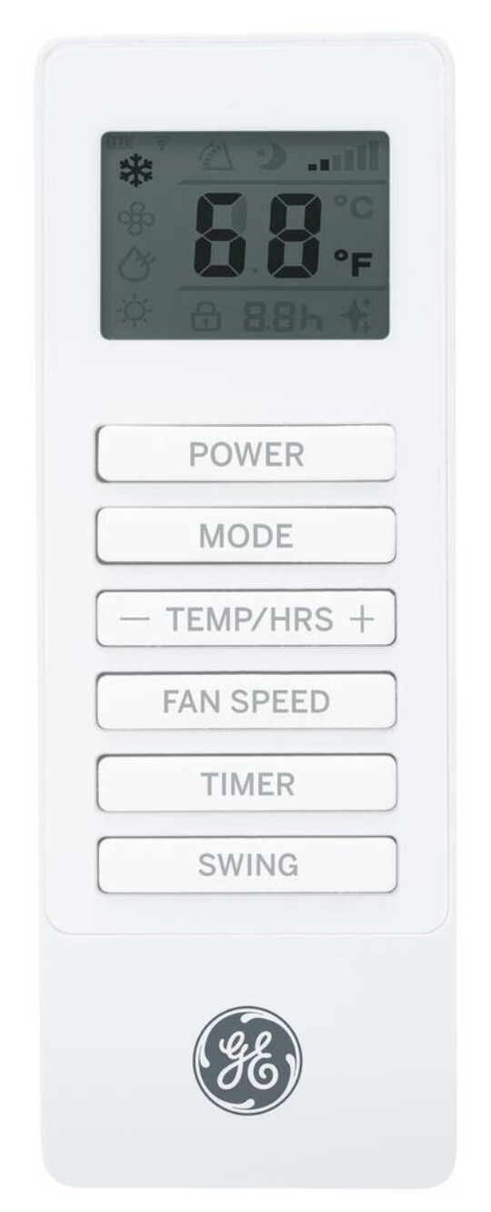

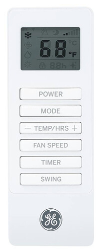

Just adding this here to save someone time in the future. This is for a GE Portable A/C which has a remote with an LED on it. These are very interesting because the remote knows what mode the A/C should be in and every single command across the entire spectrum is a discreet code. Where you think the temperature setting, for example, should be just codes for + and -, it’s actually sending a different code for every single temperature set point.
This is just from my Broadlink RM Mini, you can ha core stop your system and simply paste the into yours then ha core start. Otherwise extract the codes and use them however you like.
This was a very time consuming project to collect these codes, especially all 24 timer codes, but let my work save you some time ![]()
My model is the APCA11YBMW but I suspect this is for any that use this style of remote:
