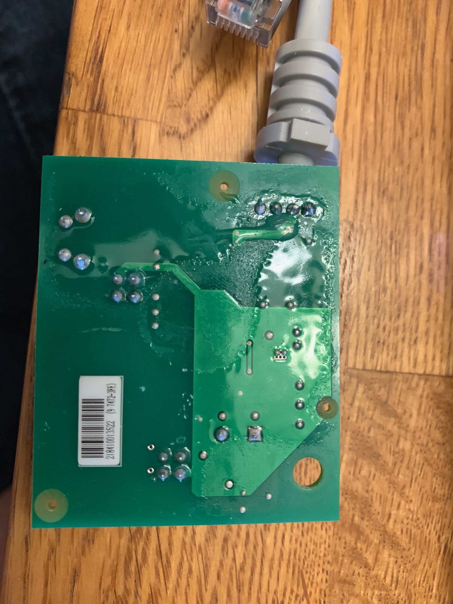

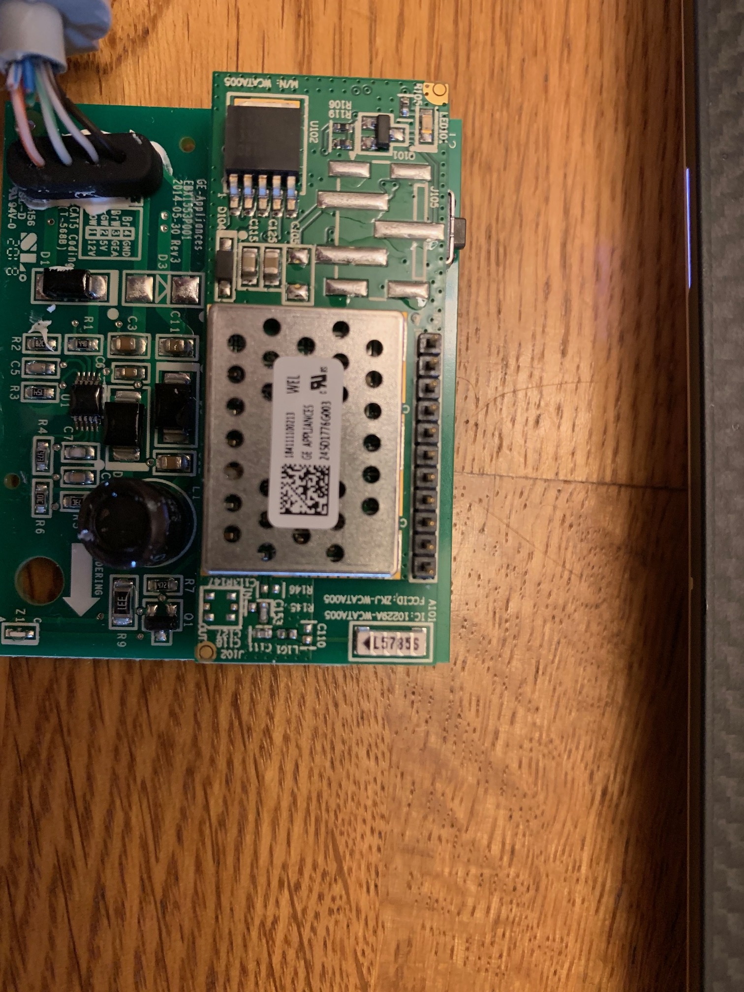

I did a bit of digging and couldn’t find any info on an api. I have a washer that uses a wifi connect module as well. When it works, it’s great, but the app is flaky. I’d love a direct integration with HA. I’ve even considered cracking the module open and doing some snooping, but I don’t have a logic analyzer or anything like that yet. The “inputs” from the washer are ground, 5v, 12v, and something labeled GEA. I have a spare wifi connect module I’d consider donating to the cause if someone thought they could reverse engineer it.
I have some pics of the internals of the module:
