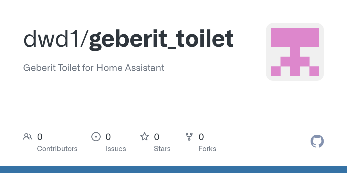

Here is the first beta release: GitHub - dwd1/geberit_toilet: Geberit Toilet for Home Assistant · GitHub
Please test it in many type of devices, I only has a DuoFresh.
All and any feedback is very welcomed :slight_smile:
The latest public release (v0.2) is buggy, so pls dont use it. :slight_smile:
v0.3 is coming in the next few days.
Complete rewrite is in progress...

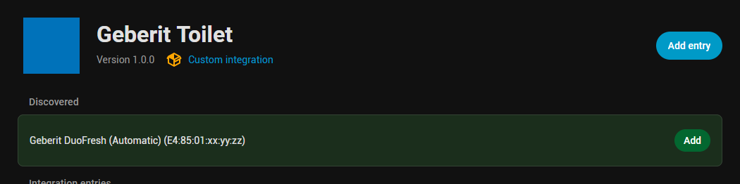

Okay, sooo much rework is done, v1.0 is released. :tada:
Please test it :slight_smile:
