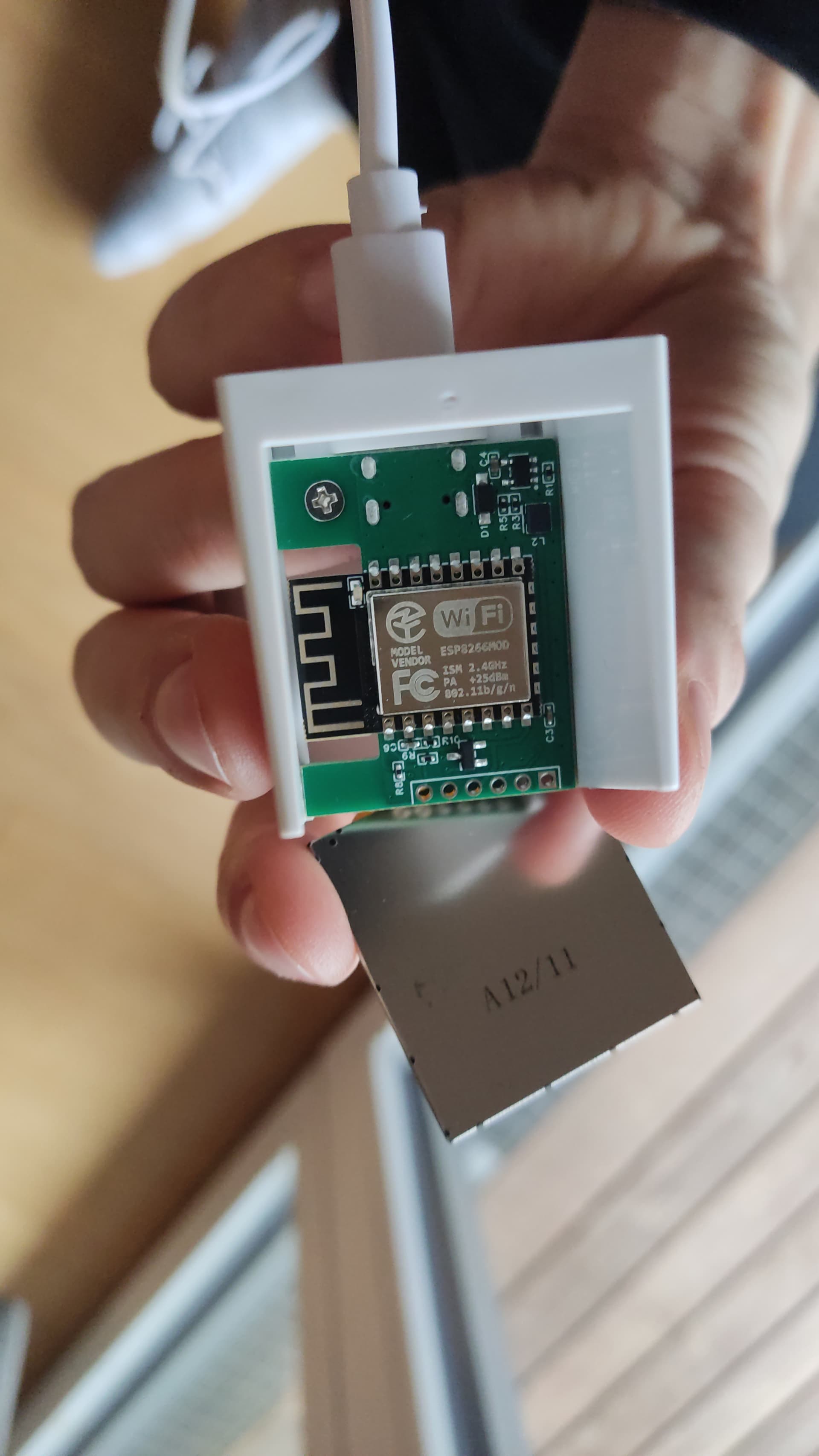

I just bought a geekmagic ultra and may have already bricked it.
I followed this tutorial, but my guess is that the board may be slightly different.
I used this yaml code provided in the tutorial, just adjusted with my wifi secrets.

After flashing, the screen went off (expected) but the device never appeared on the network. It also doesn’t show in my router, lsusb, or ESPHome Web (no serial device detected).
How should I proceed?
Is there an easy way to revert to the original firmware?

You have d1_mini defined as board. It has 4mb flash. But in case yours has just 1mb, it would fail to run.

no, but usually these boards have jumpers ors buttons to reset.
Hi @MrPopolino, I’m facing exactly the same issue. I’ve already bought a UART-Adapter aka “USB-TTL”, but I’m not quite sure how to cable it correctly and of course I don’t want to roast this thing at all :slight_smile:
Have you already made any progress to this?

I'm not sure if this can help, but I just made a PR in the ESPHome Devices repo for the GeekMagic Ultra. In order to help people understand how this can be flashed.
Note: To enter flash mode, GPIO0 must be pulled to GND during power-up.
