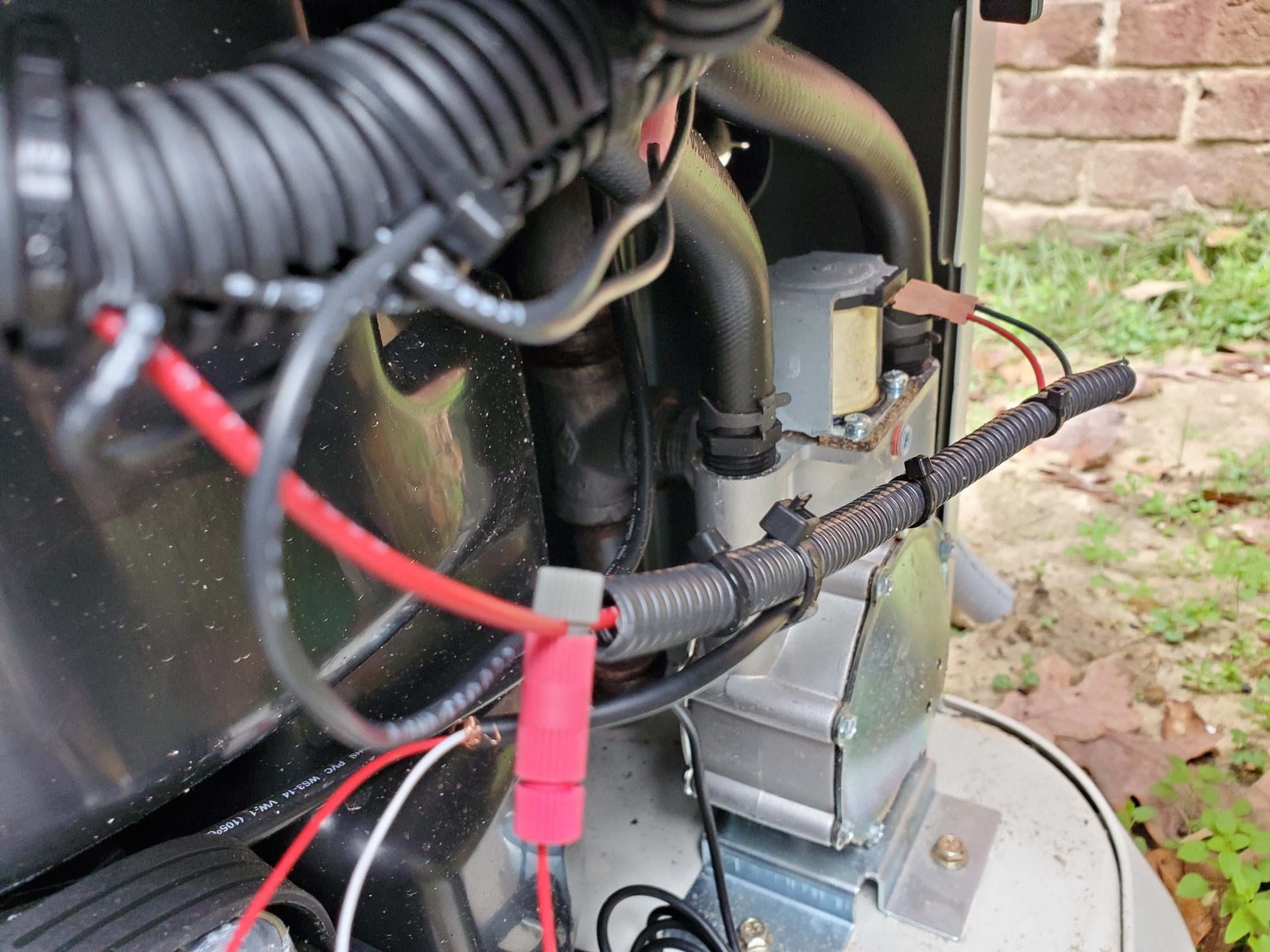

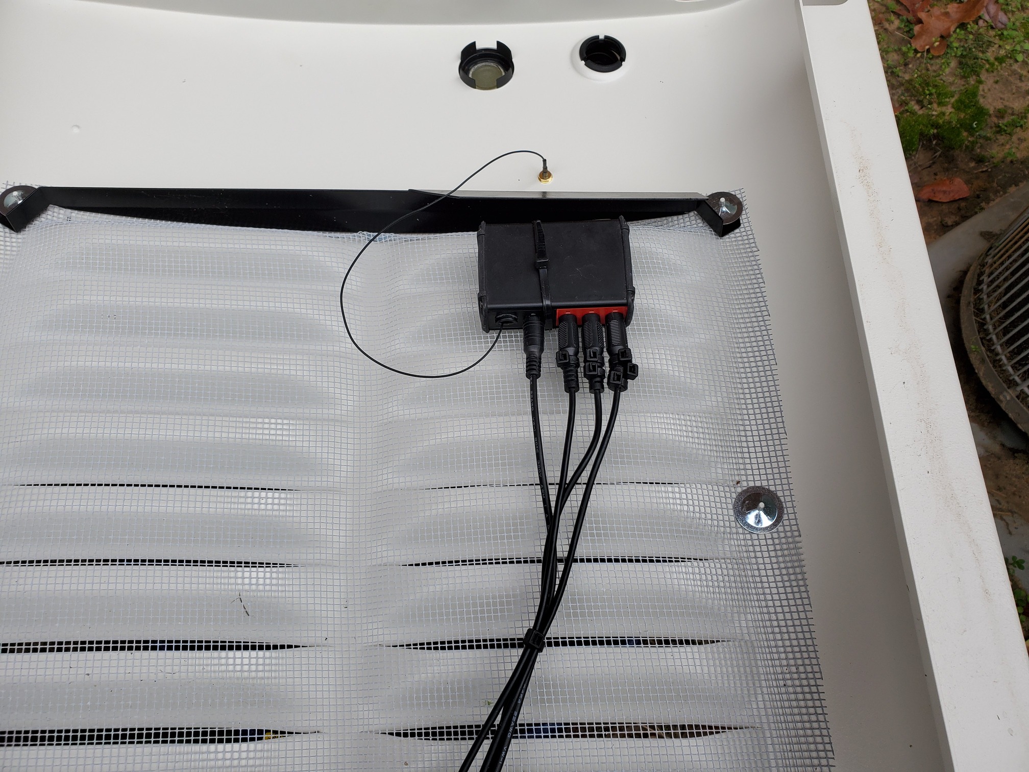

Had a backup generator installed this year. Has wifi capabilities but didn’t want to commit to the monitoring/cloud fee. Generator also sits on a side of the house we rarely pass by to see the status LED on the unit.

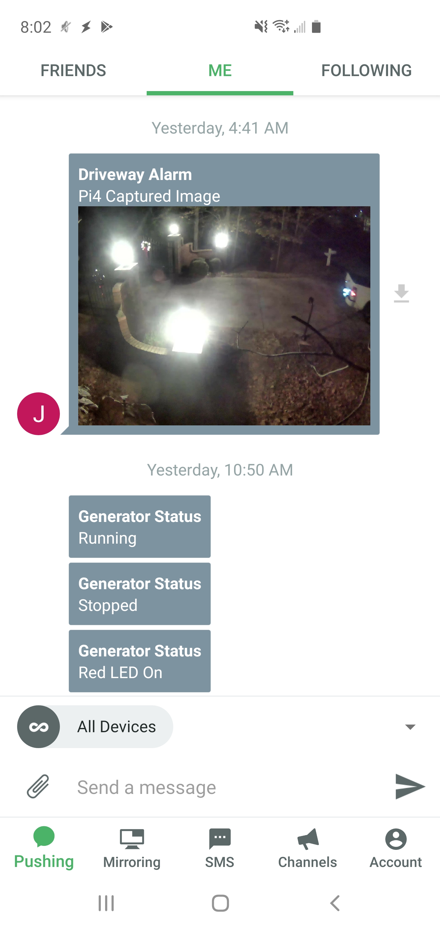

Using a wifi2ir global cache (ITach) to watch voltage to the gas solenoid, yellow, and red LED status monitors for hardware.
